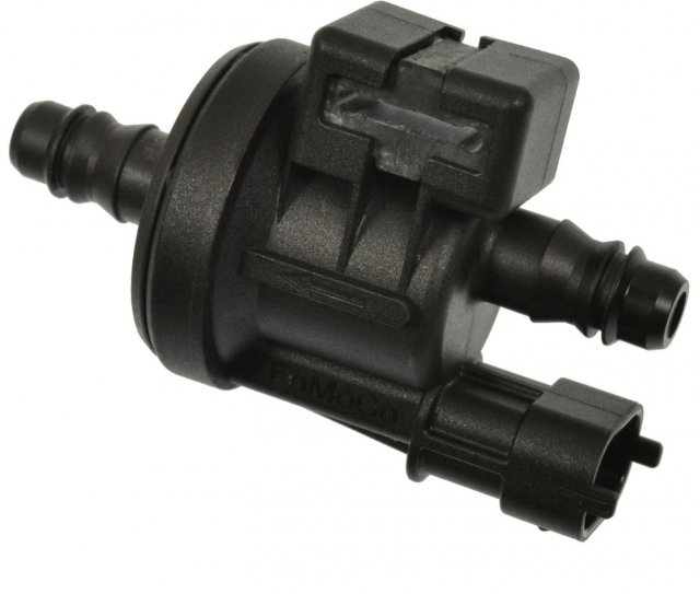

My daughter has a P0456 code on her 2018 Fiesta. I was doing a little research and the most common thing I can find is the purge valve... Duralast part#PV968. I cannot find it lol.
Am I blind? Is this not the right part? Any help would be wonderful!

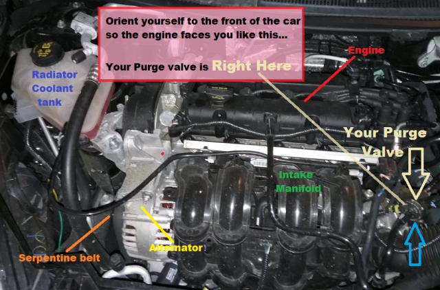

Thank you and I will check that out. In the meantime, since I already bought the part.... any idea where the thing is located? I can't find it! Lol
1,505
1,171
Oh, it's here...in the front engine compartment - right above the snorkel - you know - that ribbed hose thingy...

They both would work, but one has the right angle - does yours have that same connector - straight off versus a low-profile?
The Connector "ends" the ones that hook up to the pigtail, are or should be the same - they both would work - just from different manufacturing sources.

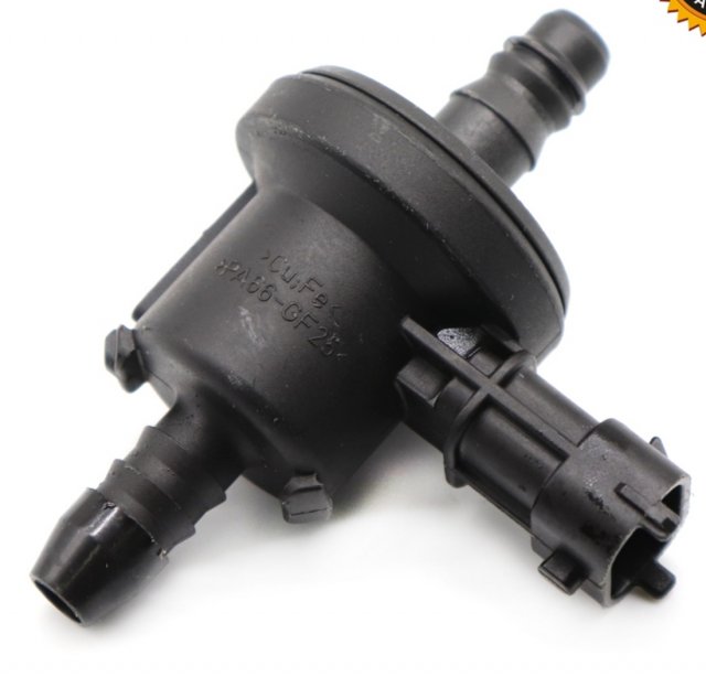

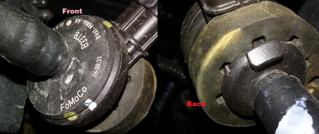

The one on the car looks like the one with the right angle and the one i bought is the other one. The hoses seem pretty stiff and like they wouldn't easily conform to changing from horizontal to vertical alignment.
764
616
Oh. Maybe you can get the part # off the old one.
