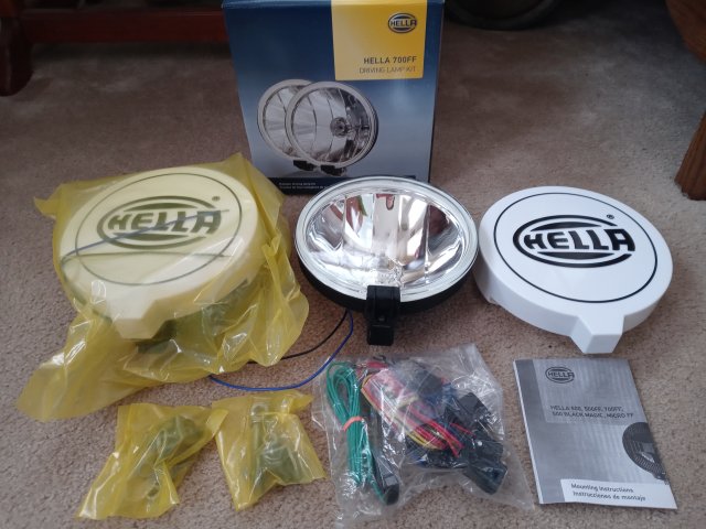

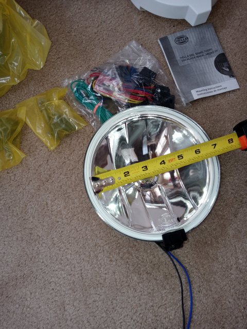

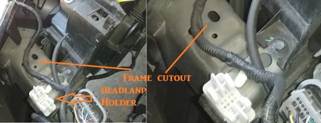

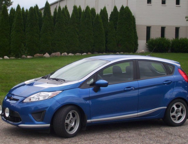

I will be trying to end up with something that will match the shape of the lower grille opening. But, will have a protected provision for these large-ish Hella driving lights that i couldn't resist the online price of.

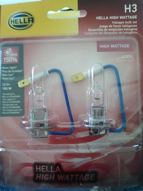

I might be able to do a 100 watt bulbs and relay upgrade to these too, still looking at the possibilities for that.

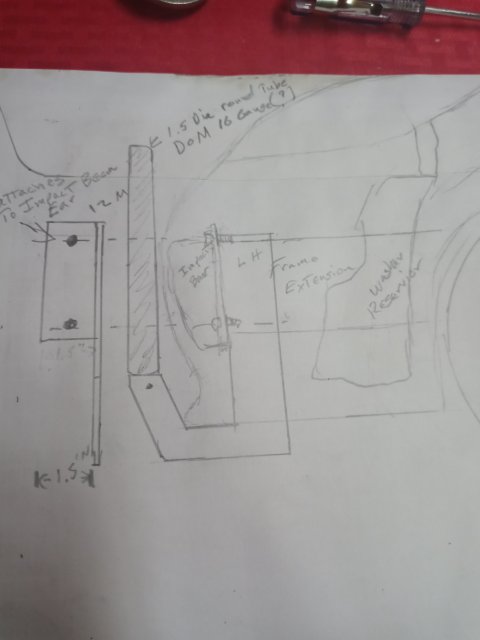

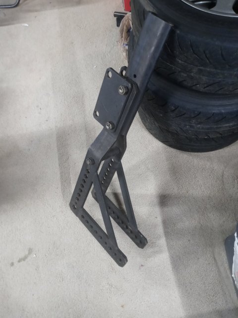

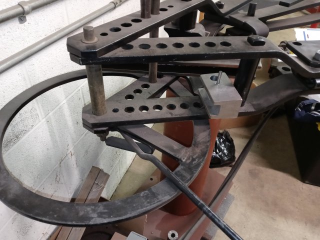

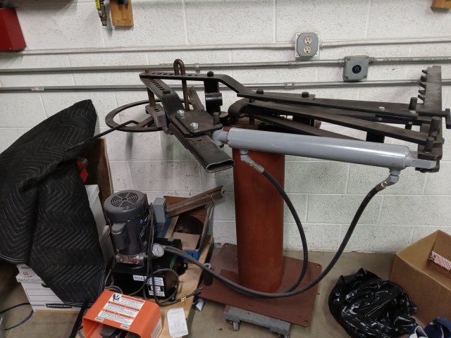

This will be a late spring project. I still have to figure out what tube diameter and gauge would be best. I also might have to order the tooling from Hossfeld Mfg, if l don't have the dies.

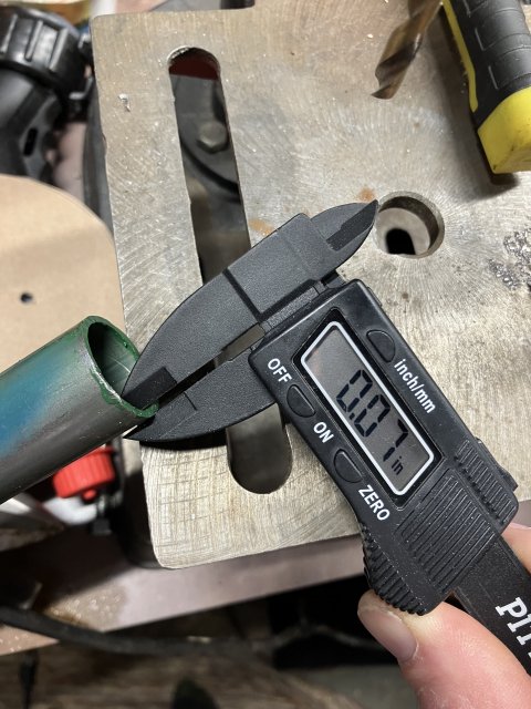

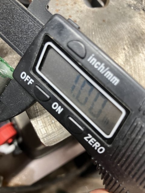

I would welcome input regarding how "robust" you guys think that a Fiesta light bar should be? I think that it could be almost " bull bar or push bar robust if the mounting brackets were thicker and the tube material spec was DOM 1.5 inch diameter. I'm still riffing on the material specs at this point.
