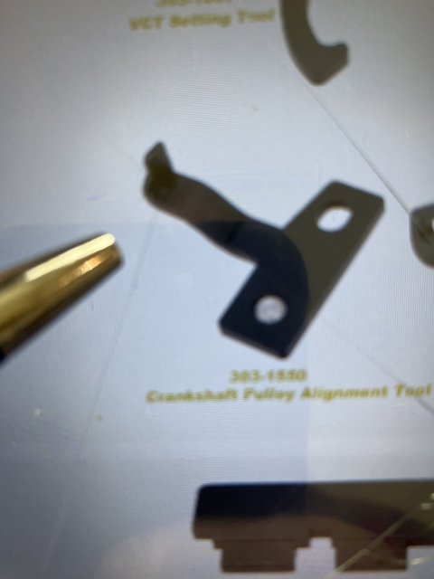

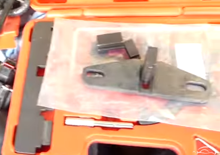

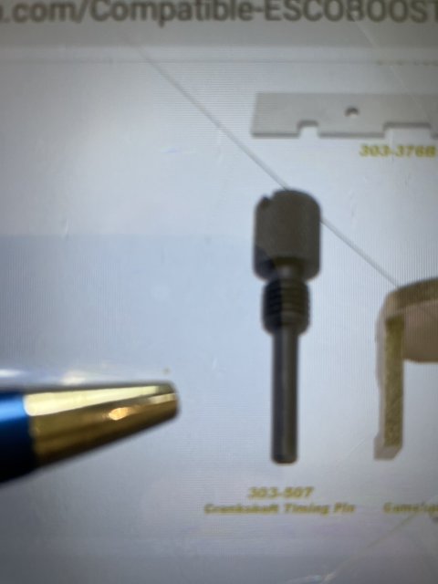

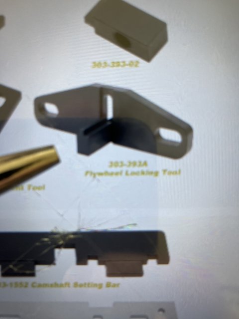

There are three special tools that set the position and alignment of the harmonic balancer. One is a pin that is inserted through an access hole in the block and the other one is a locking bracket that engages the flywheel and holds the crank in TDC.
The crankshaft pulley alignment tool (Tshaped item in middle image) is the damper pulley alignment tool.

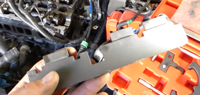

All the "timing" sensor figuring out, is done to the rear, the two upper cam sensors (Intake and Exhaust) with a third - the output at the Crank, is the Crankshaft Position Sensor - and it's position on the bell housing that mounts the flywheel - the clutch, or flex plate - to the transmission.
There is also a bar you apply ACROSS the output side upper cams - fixes two camshafts that once properly aligned - this tool drops into place lets you then fixate the cams so they don't move and let you put on the belt on the front.
There are two sets of cam stop tools - one to the front is the curved piece that locks the pulley gear set in proper position, but the camshafts themselves have to be set from the rear, that is a long bar that drapes across the two cams and a slot or opening in the cylinder head for it to drop into place and fixate the cams once the front pulleys are set.
I never needed to remove the crankshaft pulley when I did the timing belt and water pump. I didn’t buy these items then. But, they are at the top of my list now.

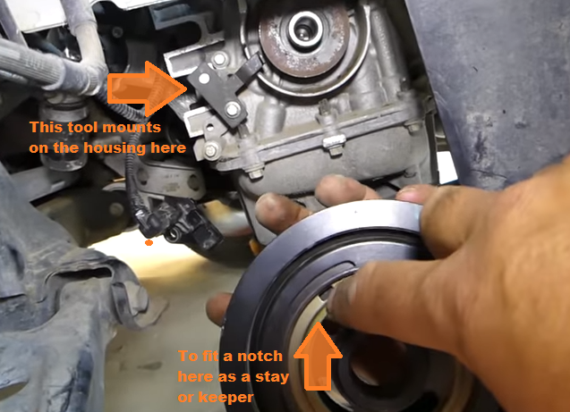

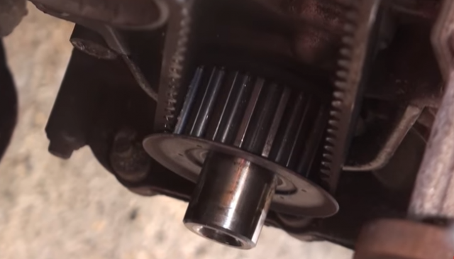

View attachment 7954 View attachment 7955 View attachment 7956 Thanks for the reply but I have the whole kit. including the T shaped harmonic crankshaft pulley alignment tool. My issue is there is nowhere to connect the tool to. There is no crank sensor next to pulley. I had someone tell me my engines crank pulley just goes on in no certain position just use proper torque specs. I still use the pin to set crankshaft at tdc with stopper where the starter goes to tighten the crank bolt 74 ft lbs, then 90 degrees wait a whole minute then tighten 10 degrees more. use of X camshaft lockin tool as well.

No slot on my pulley.

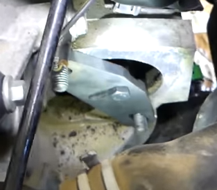

Ok, that hole you're referring to?
Goes with the third tool - the one just below it - it uses the "Hole" on the flywheel.

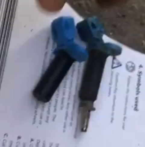

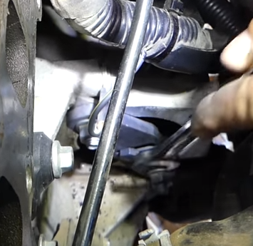

Can you find this sensor?
IT's located on the bell housing on the rear side where the transmission goes.​
Once you locate that, you'll also know that you'll have to remove the starter...to obtain access so you can use the bolts the Starter mounted to, to put in this tool
Mounts where the Starter went
...that tab engages a tooth on the flywheel...
You align the flywheel to let the tab slide into the tooth "gap" the flywheel has.
Note that you will have to rotate the crank CAREFULLY to find the alignment gap to let the tab drop into place.
So that means...
Have you found TDC yet?
So that means - the above photo shows, that the head of the tab bolt is towards the center axis where the crankshaft is - slides down - so the bolt slides the tab into that notch and holds it in place.
Might want to post pictures of the inside and outside of the Harmonic balancer - so the Hole you found - I believe there is a pin and bolt combo you may also have to set the balancer.
The above just sets the crank to set it in position so when you're at TDC the balancer can get tightened into position once the belt and shield and all guards are in place.

I'm trying to set the timing on a 2014 Ford Fiesta. I bought the timing tool. I have everything apart. I have the camshafts all set with the locking tool. I have the bolts in place to set the engine at top dead center. I pulled off the harmonic balancer. Problem is there's no place to set the tool to align the harmonic balancer. The question I have is how do I set the harmonic balancer when there is no slot on the back of the harmonic balancer. There is however a round hole on the top of it. There is no spot to put the tool so how do I set the timing of this harmonic balancer. There is no crankshaft sensor beside the harmonic balancer. Advice please and thank you.
