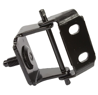

I see, you kinda' got a pickle...
Part number
Hinge - Ford (8A6Z-5842900-A)
The upper - the hinge - on the side of the hatch (or hatch side) those are not easy to get at so to remove them is nearly impossible while it's on the car.
So either "cut" the pin and then suffer having to drill out and find a pin to fit and replace it
OR try and go thru the trim in the interior of the car to keep it OEM as possible.
So if the damage is on the lower body panel - best to stick with the interior trim removal and go from the inside. The lift weight though is pretty high - about 150lbs - so you'll certainly need two men to do it.
The Harness uses two clips - male female approach to that should be in the boot or nearby in the interior side. You can have up to 4 wires connector combos (USB cameral - lamps, hatch release Wire for Rear window defogger) for this all using connectors - so you'll do the offset approach - meaning that each wire and its connector pop out before you go to the next one. To get room to make them so they can be fished out - just remove the gasket at the body side so the boot harness itself can fish out easily enough. - One you have the hinges loose, lift the hatch, roll it back on the lower latch - it's bolts undone so you can have some adjustment so you can pull push the connectors thru.
