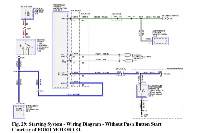

The Starter "engages" when that Yellow wire gets grounded, IGN and START are from the Key - and supply power for the PCM module to "ground" that wire and start - thru F10 that relay and the Keyswitch is thru F1 - 15A fuse
So if all the wiring is good, and the PCM grounds are correctly installed and all the connectors are "seated" - then it should start or at least crank - the Solenoid takes care of the rest, solenoid puts power into the starter motor off the Battery's Alt(Charger) and Starter post - with it's main 450 A fuse.

Well, to help, look at it from the standpoint of what is getting power from where - you know you have KEY for you have Ignition...
But, does the Dash light up all those ICONs in the START position?
IF not, then look at post 7's graphics - see that Blue wire? Heads off to the PODS on the Dash, that means the IGN and START are forcing those ICON (Idiot Lights) on - by putting power into that wire.
So, if IGN shows the LIGHTS, great, but does START do this too?
Then the White-Green wire by default, would also force a display message (Audio Control Module ACM) - your - PRESS CLUTCH or PRESS CLUTCH AND BRAKE - to START.
White Green wire heads to power the Relay in the Engine compartment from START. (Hot only in Start)
So the above might help provide your mechanic a route to take to trace and track down those wiring issues.
If you don't get these colors on your TV set...
If no lights to the Dash, that Blue-white wire is damaged or open or not seated.
The Yellow wire grounds at the PCM - forced when the PCM sees NEUTRAL or PARK or CLUTCH switch - being engaged - clearing the Wait condition until you do this - in the message display.
So locate the big Junction Box in the engine compartment and look for that starter relay - and trace that set of contacts to do a continuity check to the PCM, battery and the IGNITION switch and its harness to see if the wire is still good.
