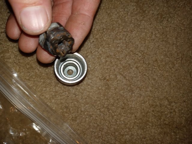

If a person has these lock sets, do yourself a favor and go online to www.cs.mcgaurd.com and register the lock set number on the package with McGaurd corporation. At least then you will have a much easier time if/when the key gets stripped out ( see image below!) Or is lost.
I found the messed up key in the image last week. It was tossed into the foam tray that sits in the spare rim of Jaguar F Pace. At least they were honest enough to put a regular wheel nut from the kit on the affected wheel.
They simply over torqued the locking lug and tore out the pressed in "puzzle key" guts!
Everyone should probably just loosen the locks when they get to the tire shop and tell them to be careful with the key!
