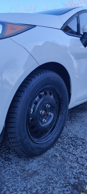

2019 Fiesta S
Before my car got totaled I upsized to 195/60r15 from 185/55r15 and honestly it made no noticeable difference for highway driving. Still humming away around 2.7k + rpm's doing freeway speeds.
Pictured: Blizzak 195/60R15 Winter tires on a 2019 Ford Fiesta S Manaual

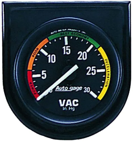

  • In earlier times - one main piece of gear that people began to use was Vacuum gauge to help determine the load to the level of efficiency (throttle used) - and one way to determine this was by using a Vacuum gauge to help tech you how to set your speed and throttle use by observing how much the engine worked - by monitoring the level of vacuum - the air below the throttle plate getting put into the cylinder - as a means of showing you how much throttle and effort the engine did - in inches of Mercury - or vacuum.
AutoMeter ©™ #2337​
  • The basic idea behind this tool was simple. Drive the vehicle normally and observe the needles position as you can do so safely and note readings and their changes as you apply throttle, reduce throttle - coast and rest at idle.
  • The needle shows the ranges of Power (RED) and Poor performance (POOR) while Best Economy was where you should keep the needle by modulating or the pressure you applied to the throttle - for best "carburetion and fuel economy".
  • The above also told you how much wear and tear was on the vehicle and if it was in need of a tune up or timing adjustments by reviewing how the needle acted when in different driving and idle conditions.

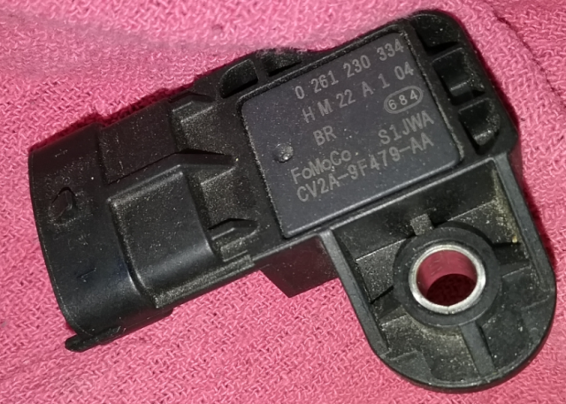

  • In more current times, Fuel Injection and MAP systems - they are the new way the system is monitored and adjusted for best Emissions - you simply apply the throttle and the vehicle simply "tunes" the system to perform - maybe not by what you expected, but for best Emissions and Fuel Economy for the Power you're demanding from the system, it can deliver.
Your new "Vacuum Gauge"
a sensor that sees vacuum as a pressure in a varying electrical signal
that the cars Ignition system can process and perform accordingly.​

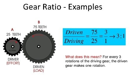

Ok, what do I mean by 4.15 versus 3.82?
Well, easy enough to simply look at the Pinion and Ring gear of the Differential - how many turns of the pinion has to make before it completes 1 full turn of the ring gear? (Think that the Smaller Gear - is your driver gear, the one that comes from the Engines Crankshaft - The Driven Gear, is the "tire" or your Output side - which is larger and has more of the teeth to engage that Driver (Engine side) gear)
The more turns of the 4.15 Pinion, means more torque but you loose speed because that pinion- being smaller, turns more frequently than using the 3.82 method. The 3.82 Pinion turns 0.33 less revolution (compared to the 4.15) of turn to make the ring gear turn once.
That equates to less RPM is needed to make the Differential make that one turn - but again, a loss of torque to obtain the distance in turn affects the speed - you'll go faster for more distance (at that level of RPM) - but less torque is made available to make the speed - which that means to keep the speed, you'll have to apply more power thru the engine to keep the RPM up.

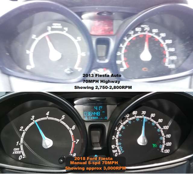

To help further...
(apologies for that shaky photo - but while driving an older car - some suspension issues are always evident - and in light of these posts - also demonstrates the performance level of long term damages rough roads and tire wear can present to the driver trying to keep their car serviceable for longer periods of time)
This is an un-calibrated and certainly not side by side comparisons, but it does demonstrate the ability for the Automatic when on the highway, in lockup (read as no converter or other forms of loss)can be driven at highway speeds in lower RPM range. Not by much, but it does show that with the P195/60/R15 compared to the OEM of the vehicle I have which are P195/50/R16 of a 5-speed stick --- there is a small (albeit less than 10% change - or your 0.33 difference) gain obtained - but at the price of the higher speed and the conditions you have to travel at to gain that advantage.
Ford lets the Auto win in MPG but only as the benefit from the gearing associated with what we discussed earlier.
The RPM change is relatively small - but in fuel savings versus the raising the tire size to obtain that figure of merit...
  • Being to drive 70MPH at 2800 RPM

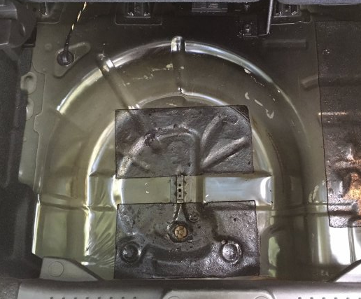

Make sure it fits the wheel well that the spare came in
- else you'll be looking for a way to store that tire that needs repair in a spot it won't fit.
This becomes an issue when you're travelling or on the road and need to fix
a flat tire in an emergency with your spare.
IF you use the wrong sizes - your broken tire may not fit in the space the spare came out of.

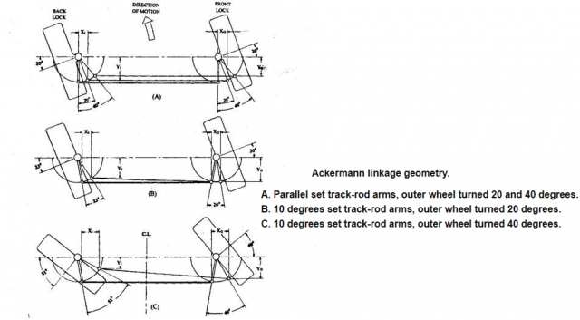

A good example of how to approach this is to think of this as the Ackermann principle.
The Ackerman principle looked at steering angle as a radius of a turn - with the distance to the radius center - being an imaginary point - so the steering angle geometry then took the inner tire as turning a tighter turn radius than the outer wheel - in this Rim Offset issue, this effect is magnified because of improper toe in and toe out which magnifies the drift and steering effort in a test such as this.

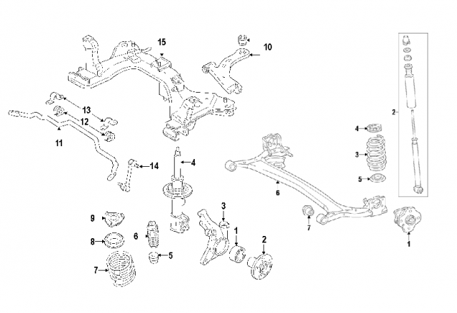

On a crazy note, the Fiesta is "overburdened" when it comes to the suspension that most cars
use these days - a sway bar, links - even the control arms and the geometry seem to be more
than necessary, but then too, Ford was based out of Michigan - the Heart of the Rust belt
