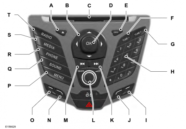

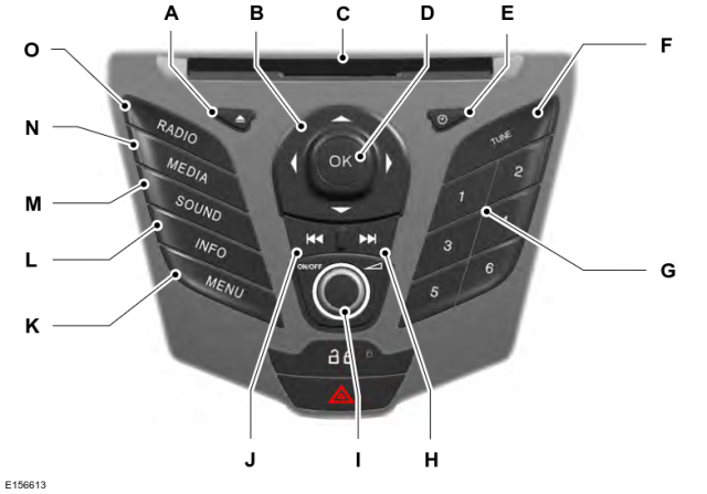

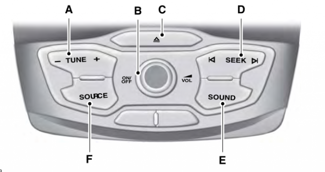

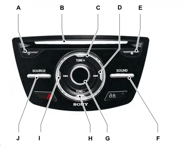

So you know, we may need to see a pic of your radio console so we can help you navigate it.
Why?
Here...
Pre-SYNC / SYNC from MS-Windows (2008+)
Another console...
Post-2013 Fiesta with SYNC note Full Numeric (0-9) Keypad (H)
and 4-button "Option Select Menu" O, N, J and I
Along with...
Touchscreen display select...
And finally...
And Touchscreen with Cursory Home and 8" panel display.​
Which one you got?

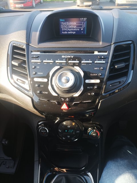

I saw elsewhere online about pulling the SYNC fuse and disconnecting the battery tried both of these but still not able to access audio from my phone or USB drive.
Here's a picture of the console I have.
