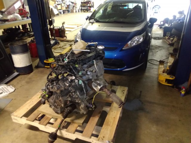

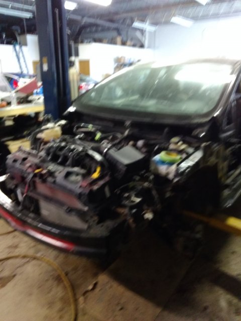

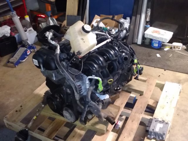

I finally got the time to drag the front half of a vandalized 2012 Fiesta sedan onto the hoist and remove the engine and transaxle. It runs and drives great, but the body was too mangled to save. The rear of the this one is being slowly converted into a gas grill (on a retractable arm out of the trunk compartment ) and a C02 fed keg beer tap system in the front! So, this party car is destined to be a party in front and back! I have added a towing tongue to the bodytub after welding the rear doors shut. I'm still working on the lid over the former back seat area. It's a lot of work. IMG_20190615_125012.jpg IMG_20190617_151140.jpg IMG_20190617_151108.jpg

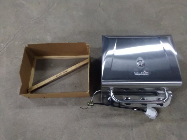

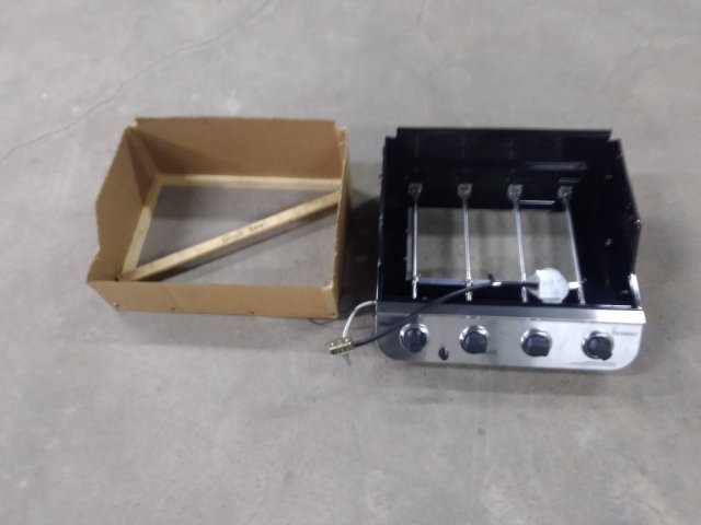

I started with a new Charbroil grill. I am only using the broiler top, lid and fuel supply lines. I would like to try to keep the (not shown) side burner.But it would have to be made to fold up close to the cook top. These are comparison images of the almost finished lighter " faux" cardboard dimensional model and the real deal. The actual grill top has a lethal number of sharp edges that makes handling it very difficult and potentially bloody.

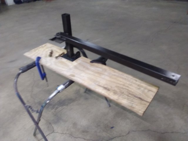

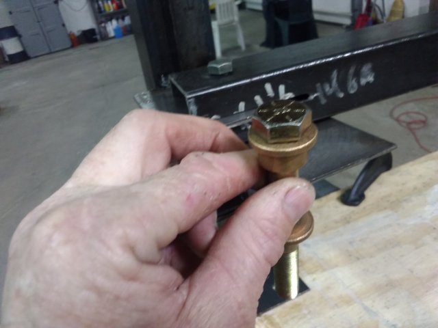

This is the base and primary swing arm before I drilled it for the bolt/pin with bronze bushings.
I am thinking that I will swing out the grill and pull it over about 12 to 14 inches from the rear bumper cover. I don't want to melt the cover. Plus, it looks bad to catch the damn thing on fire just to cook a few burgers.
I originally wanted to feed the propane line through the arm and then to the front of the tub. But, the line is not that bendy. And I think I can wrap it in heat shield and tether it to the underside well enough that it won't interfere with the swing path in/out. That remains to be seen.

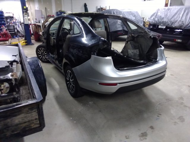

This is/was the raw material for the grill trailer. I have the trunk lid. But, the hinges and reinforcement beam below what was a back window are completely and crudely cut away!
This problem, along with the tailamp and tailpan being heavily chopped up, mean that I might be better off getting another sedan tub for parts that I can much more easily cut and change into a BBQ Fiesta grill. This one is ok for fabrication purposes but that missing rear bulkhead and trunk hinges are a huge problem ( IE; the body shell is not dimensionally correct anymore) I also could use a hatchback rear section. The shorter stowage area is offset by the greater headroom which not having a trunk lid provide me to not need to cut down the grill lid height in order to get closure. IMG_20190505_112835.jpg
