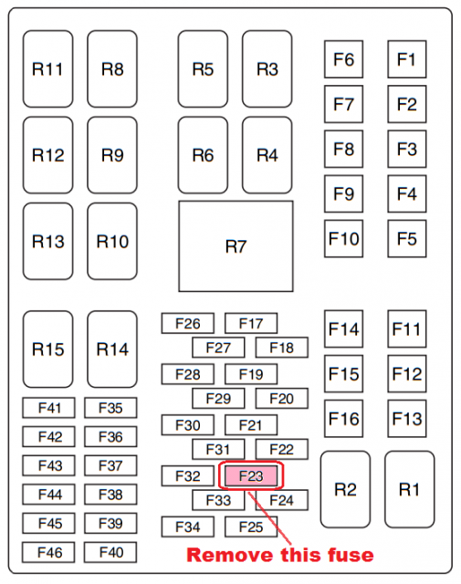

Why? For in some vehicles - they have a fuse separate for it.
Others have the "OFF and or a "P" - so if yours doesn't - then locate your Engine Fuse block
Find F23 and remove it - its blue in color and has 15 stamped on it.
Pulls the power for it, won't bother you again - until you put that Fuse back in.
