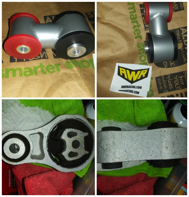

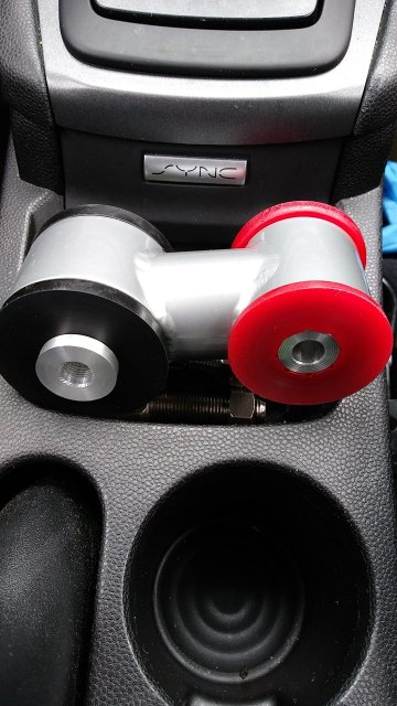

There is finally an aftermarket RMM available for the DCT equipped Fiesta! I have been driving with the prototype for one week now. I have the 70A RMM. Light acceleration and deceleration, including braking to a complete stop, is so smooth now. Heavy throttle acceleration and upshifting/downshifting is crisp. The engine is more stable throughout the entire driving experience. NVH has barely changed. There is a very slight vibration in the steering wheel and side mirror, but is barely noticeable (I have driven extensively with the AC on). Noise has remained the same, although the exhaust is already noisy so I couldn't tell any difference. Lastly, the motor mount itself is really nice looking and the welds are of great quality. I highly recommend this mod to all DCT owners out there. https://store.awrracing.com/2011-2019-1-6l-fiesta-rear-motor-mount-s-se-ses-sel-titanium-models
AWR RMM on top row and stock on bottom row.

You have the 70 durometer version. Could you get them to let you try an 88 duromter?
I also noticed that they sell a RH motor mount, also with four bushing hardness choices.

I can order an 88 one but wouldn't be able to try it for free. I would think that 88 would be fine if its going on an autocross/track Fiesta. For perspective, I would say that the Energy Suspension rear motor mount inserts on my ZX2 results in about 3xs more vibration. Be aware that this RMM is for a DCT. I am not certain but I believe the manual base Fiesta motor mounts use the ST versions offered by AWR racing.

Ok. I've got the same inserts on my ZX2 lower mounts. So, in your opinion the Energy inserts in the zx are way more harsh than the upgrade 70 durometer mount in your Fiesta?

Yes, the vibration in the ZX2 from the ES inserts are harsher, particularly during idle. Oh okay, well this would be a great addition to your project car. Not sure which durometer would be your preference though.
