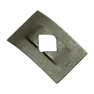

That is if you want to use plastic, I don't, I've replaced much of my "broken" hardware from around lights and front plastic bumper and interior trim with steel nut and bolt to be able to use washers and fasteners to reduce rattles and even help with keeping the headlights aimed.
The plastic rivet you mention is some I've replaced with a SS and flat-plate speed nut to hold it with the bolts' threads sticking above as a sandwiched fastener and then I put a nut with washer on the top side of the pieces it presses against to hold it down to the front radiator/cowl piece.

To help some more, when you know Ford is NOT going to take you down their repair road further than they have to. I've found that using or making fasteners work using the local hardware stores to be more beneficial in specific cases - like using those speed nuts with a Stainless Steel (SS) bolt - with it's head threading up from below, on the fixed fastener side, the speed nut will hold the bolt in place when it's tightened and then you can use the simpler wing nut, or hex nut to sandwich the removed plastic piece to the fixed housing - the speed nut holds the bolt in place once it's tightened. By using the speed nut like a jamb nut, the bolt can hold itself and you can install the part back onto the bolt and thread on a convenient hex nut to hold it in place.

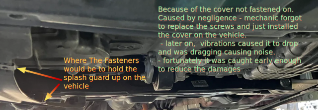

Many an oil change place has "miraculously" repaired horrible noises from under vehicles caused by dealerships or lazy mechanics for not putting back in screws from their last oil change. Some vehicles use splash or road debris guards using these same plastic rivets. They also use tabs to hold them, but if they aren't screwed together - that splash shield can tear off.
Owners takes car in for oil change - tech removed guard, changed filter - drained oil - replaced filter and plug - refilled - and drove it out to the lot to wait for the owner to return for it - not noticing the hardware left behind when he forgot to screw the guard back in place once the bottom side was completed - so the plastic eventually sagged far enough to get caught in a whack of wind or got tugged and dislodged by road debris causing the skid protection it had, to scrape on the ground - abrading itself and transferring that into a noise filling the cabin and scaring the Hades out of its occupants - all because of a lackadaisical attitude a mechanic had over properly re-installing a splash guard which took on it's own life and made a horrible noise until someone was able to see it and fasten it down correctly.
