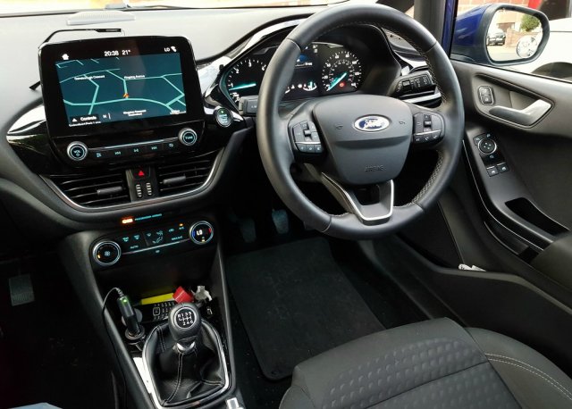

The idea of an upgrade to a Din1 tablet screen audio unit is very appealing. This type of display looks like the audio display in the mk8 Fiesta.
Given that a lot of the HMI is through the audio stack. I would have a difficult time with the sheer amount of work that would be required to keep functions like reverse camera and basic vehicle menu items like oil life monitor resets and messages. 42843366775_ccc13dbd60_b-1.jpg
