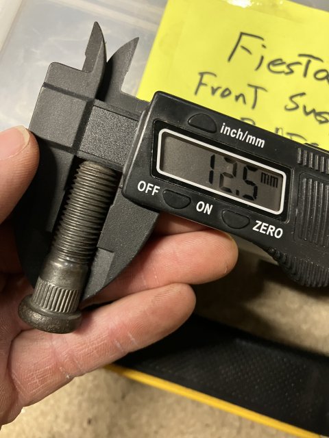

How are you measuring the wheel stud? I am getting 12.5mm diameter shank. North American Fiesta May be different. But, must agree that longer cannot be a bad thing.
I would take an original stud and go to a reputable parts store and have them dig up some longer ones by spec. Not direct application. Because, longer studs are not an original item. You would probably want to get new “open”wheel nuts at the same time, if you don’t have them already. C41CD66B-62B0-4C80-B594-1260D022116B.jpeg
