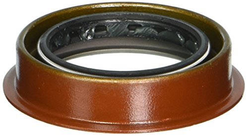

still been putting this job off. I was thinking about ordering some Amsoil DCT fluid. Anybody know the output seal part number by chance?

1,525
Any real auto parts store can cross reference a Motorcraft part number BRS174. This is said to fit the DPS6 transmission. 16036369_0.jpg
