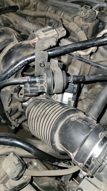

P0094 "Fuel System Leak - Small Leak Detected"
The part that has a small leak is pictured.

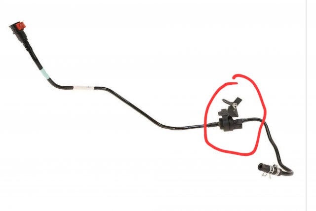

There is another part:
Purge Valve - with VMV Valve - 2013-2019 Ford Fiesta Naturally Aspirated - Genuine W0133-4129313
Looks identical only 2 difference are the retaining clips one is red and the other is green and of course part numbers.
The car has the a red retaining clip.

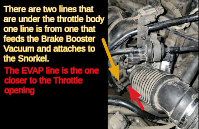

To find the correct part is to know the color of the connector that goes to the intake manifold in the engine compartment.
For my 2018 - mine is Red and also uses the "J" (8th digit) motor.
You will have to remove the snorkel and possibly the throttle body to get a better look at the color that connector is.
It is located under and towards the front (towards the Radiators direction)
Also - you may also have a TSB already done on the unit which then changes that valve too - to the newer VMV valve that like my 2018 Fiesta has, the Red press fit clamp connector.
  • - so to know for sure is to check the valve body, on that line too
  • - check to see if the numbers on that valve match the OLDER series (2011-2013) or the newer one which also has the "variable Metering Valve" which the older unit is not
    • The older unit from 2011-2013 is simpler metering valve - a simple "pulse mode" solenoid that varies with rate of pulse as the pressures detected by the sensors in the gas tank - change.
  • So it uses manifold vacuum to pull fumes out of the tank, thru the EVAP canister and then into the line to be burned as part if the "Idle speed" and Idle Air Control "budget" the car uses to trim A/F ratios.
