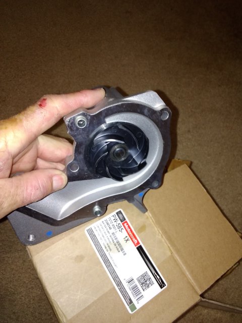

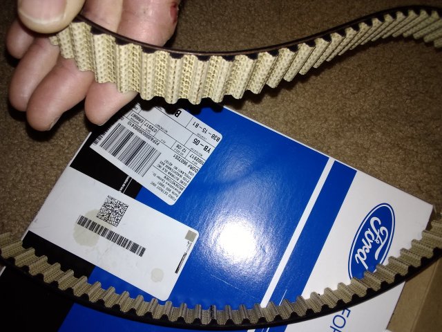

I did the timing belt, tensioner and bolt and water pump on my blue 2011 last fall.
I should have taken a few pics of the original belt condition. I have a pic of a new Ford timing belt for a Fiesta. As well as the water pump. The pump fails much more often than the timing belt. The O.E. timing belt is very robustly designed. It has a high density plastic material impregnated into the cog face. This material has to be gone through before the cog material can be chewed up. IMG_20200903_065038.jpg
The water pump does have a plastic impeller, but it is also quite beefy. The seal and bearing are the weak point of this piece.
