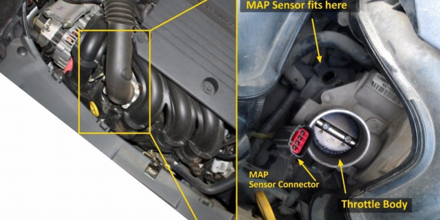

Can you tell me where to look for the MAP Sensor on the 2012 SES Intake manifold?

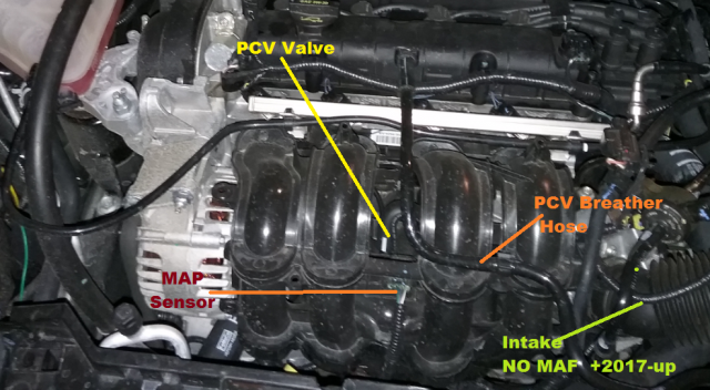

Something is not assembled right. That P0171 code usually signals an intake leak - poor vacuum - so since it was worknig ok until this showed up - the reassembly may be the whole problem; you just forgot to tighten or seat something.
The Intake manifold between a 2009 and 2012 FIESTA (the one in the USA - the intake Throttle body was in the "fold" of the manifold in earlier models.
Then about the time is was introduced (one last time for an 8 + year run) they modified the "fold" of the manifold to something like this...
The air intake was now on the transmission side - but then FORD was still working out bugs in regards to MAP/MAF so they "kept both" in several model years until they could make a program work that did away with the MAF and allowed the MAP and fuel trim to be calculated electronically.
So look for overlay of MAP between the years - but if you don't have one - remember they had two spots it could be in.
