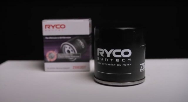

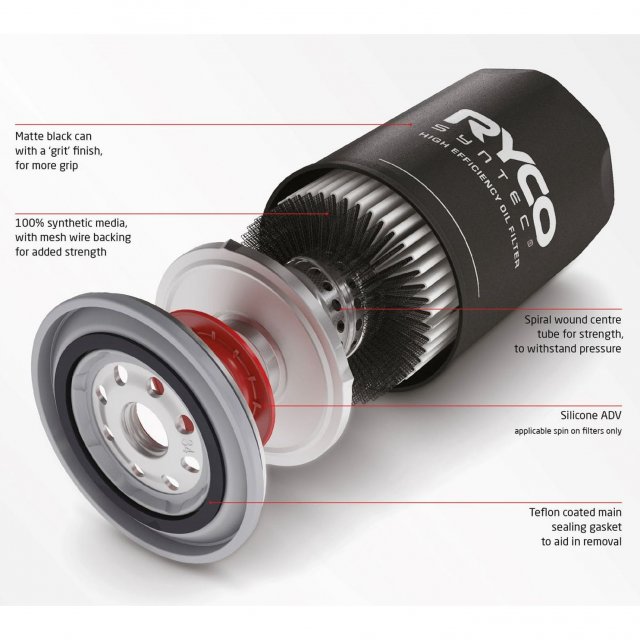

I have been using these for a while now,only available in Australia.Ryco is an Australian company,& has been manufacturing filters for decades.These came on the market a few years back,developed by Ryco.15,000kms oil change life.over 99% guaranteed contaminate filtration of nano particles.The media is manufactured in the US.Just a very good filter.Quite a few of our V8 supercar teams use them(ie:Mustang)

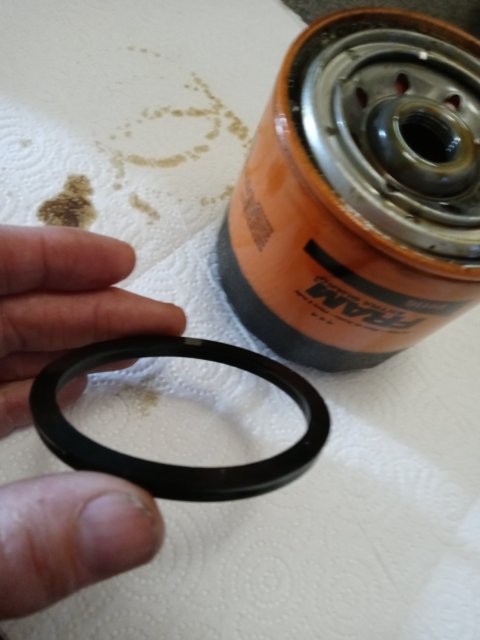

I did a routine maintenance on my uncles dodge minivan yesterday. I had chosen the "OCoD" last spring when i PM'd it. It unscrewed easy enough. But that gasket was stuck on the filter boss! I always smear oil on the new filter gasket. So, it's not just an urban legend about that issue!
I was laying on my back in his driveway. The filter came off and the gasket was stuck in place! 20211124_171510.jpg

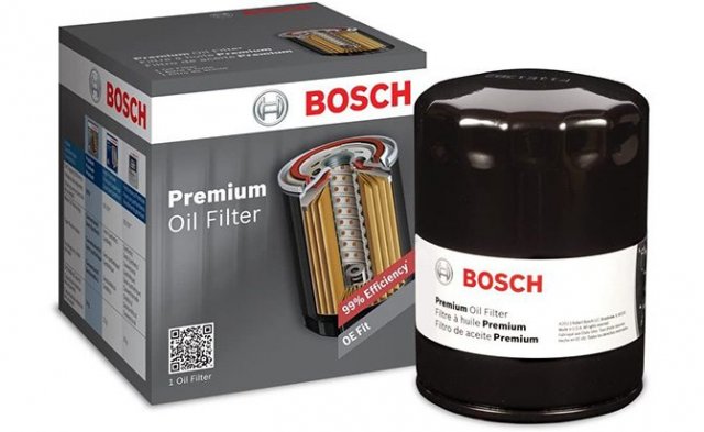

I had been using Motorcraft oil filters exclusively because I could buy them in case quantities for a very good price from my selling dealership.
I have used Bosch Premium oil filters if available in the application needed.
Thanks to covid, i don't always have a good choice of brands for the past year.

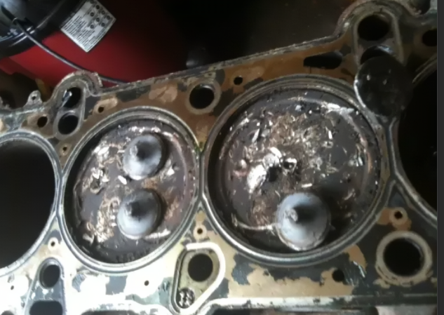

But one small aspect many don't think about - is the Piston to Valve clearance.
If the belt snaps off - the cam stops turning and the pistons don't stop on a dime. There is nothing to maintain the valve to piston clearance and timing aspect - it means the valve and the piston are going to meet.
So in some - they "notch" or offset the valve by grooving the piston head to clear the valves "flare" or flute - they call this non-interference.
Others also increase the distance in the cylinder head the valve lifts and seats into - so the combustion chamber space is the clearance. Also known as non-interference.
But...
But then there are some motors out there - I've owned several - that if you don't take care of the belt at the required interval - they are NOT all the same NON-Interference - in fact they are considered INTERFERENCE engines - where the Valve train can strike the pistons' head and damage will result.
This post is not just for us at this moment in time, this is for those that may come across this article at a later time and need to know what we're talking about - so you know what could happen - others might not ... so this is a cover the bases moment.
There's a plethora of engines listed at this link that are made by the Automakers -by size and if they are Interference or Non-Interference motors.
http://yourcarangel.com/2014/07/int...th a non-interference engine. It pays to know.
