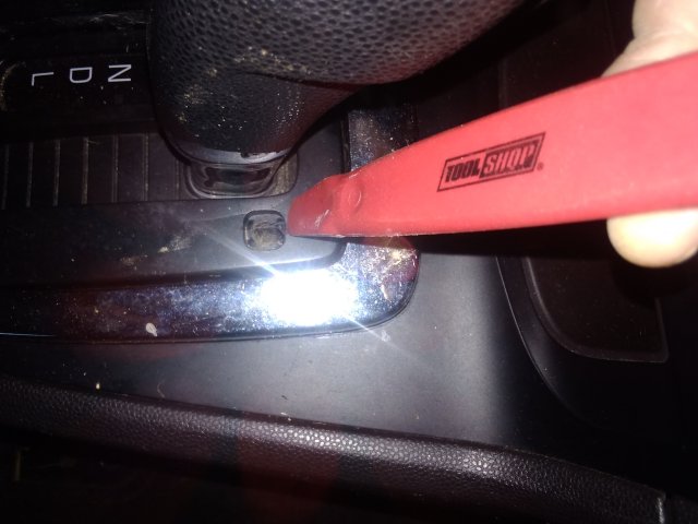

Nothing gets it out of park but thank you for your help. I'll try to look up the 2 ideas you have. Not a mechanic. Looks like someone bent the little button by the lever, it doesnt work.

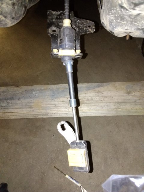

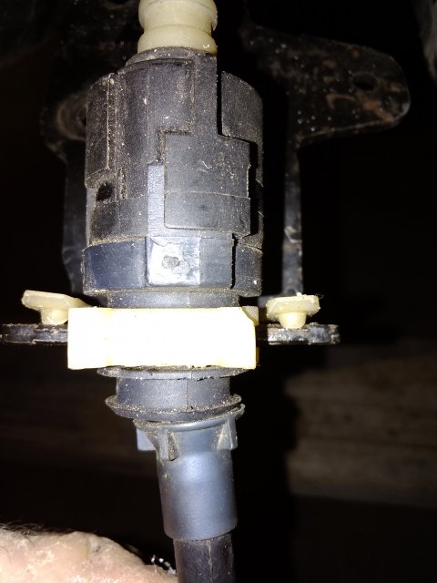

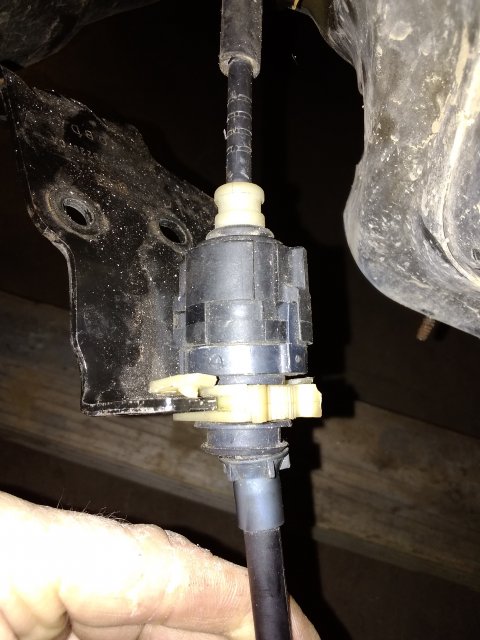

There is an actual cable connection to the transmission. You should remove the battery and it's tray to get a good look at the area where it connects to the transmission. The bracket that holds the cable in position might be bent. I found that the connection here is very difficult to get apart. A plastic retainer is on the cable assembly that might need a special tool to get it apart.
334
52
I recently pulled the drivetrain out of a Powershift equipped Fiesta. I just got a couple of images of the cable and bracket that bolts to the top of the transaxle. When I dropped the engine, trans and subframe out it was easier for me to just remove the lever attached to the selector pawl.
