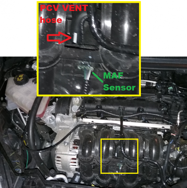

So i've got a 2015 fiesta S thats been giving me issues, and the signs are pointing to MAF cleaning or replacement. My question is, where the hell is it located? It is nowhere on the pipe between the airfilter housing and the throttle body, took everything apart yesterday (for the second time) and cleaned the throttle body while i had it off but i cant find the damn sensor. Is there something i'm missing because I feel like i'm losing my mind. Any help would be much appreciated

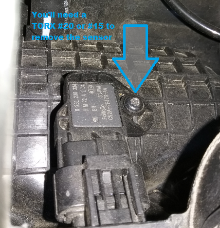

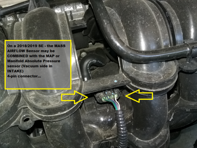

So, I believe, on a 49-state car, there isn't one. Someone can correct me if I am wrong.
674
863
Mine doesn't have an MAF there or anywhere else, either, so I am guessing that's why...49-state car?
^^^^^^^^ That's where mine lives...end of mystery...thanks Handy Andy!
