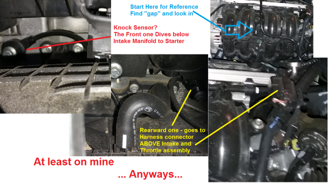

Hey gang I've got a 2015 1.6L non turbo charged DOHC and as I was replacing the timing belt I did not notate where each knock sensor plugged in at and may have crossed them... One plugs in to the part of the harness that feeds the fuel injectors, VVT, and the front cam position sensor, and the other plugs into the part of the harness that feeds the AC compressor, alternator, starter, etc... I plugged the knock sensor closest to the front on the motor (passenger side) into the provided knock sensor connector coming off the the fuel injector harness and I plugged the driver side knock sensor into the assessory, starter harness. Any help you can give me will be greatly appreciated.
