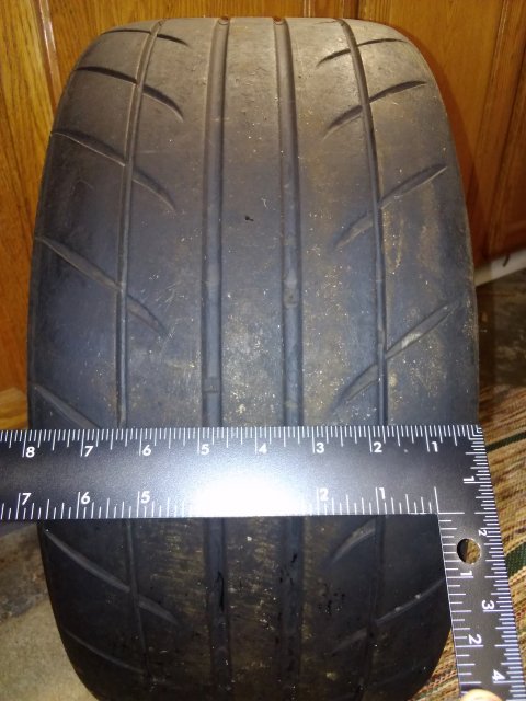

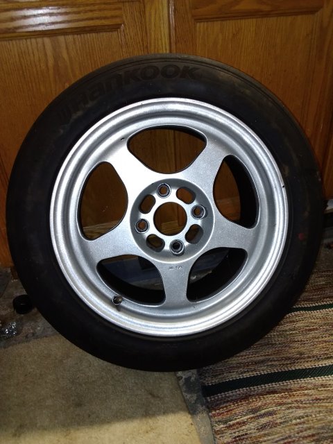

I really threw some effort at getting better road feel! The control arm bushings along with the ASB upgrades (I experienced tire slip during some autox maneuvers) and finding a limit to how much tire width is no longer beneficial to handling and actually begins to drag down the car on an autocross course. That was an eye opening discovery that day!
The tires were Hankook Ventus RS-3. 225/45ZR15 on Rota Slipstream 15X7.5 wheels.
That was the absolute limit of SCCA allowance for the Street Touring category at that time, 2012. They fit in the wheel wells perfectly fine, no rubbing. But, over the next two events I could not find a sweet spot for this setup. Various tire pressures, one event was raining on the final two runs. Found that this setup is not a good one for the wet. The overall feel of the tires was just "heavy". The steering was not crisp and the car felt sluggish through the slaloms. It did stick on transitions, but the tires didn't give a tossable feel, even if I bumped up the pressure to near 40 psi. It was very odd.
