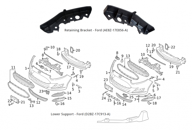

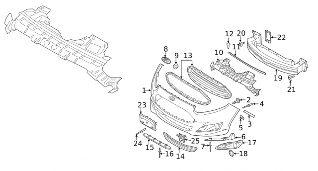

Hi hope its OK to post this here if its the wrong spot mods please move. Anyway bought a wrecked but repaired 2014 Fiesta that well looks like they replaced the hood and the front bumper assembly but I know its missing some parts underneath that the bottom of the bumper attachés on the front underneath since there is nothing there. From what I can gather there is a filler panel Ford D2BZ-12E785-C that connects to it. I'm wanting to make sure nothing else is missing underneath it. If someone can post a pic of underneath in that area or a link showing this would be highly appreciated. I did a google search but what I found is removal of the bumper but is not real clear of the parts connecting to it and where they go. Thanks! I'll post a pick of what I got after we come back from church.

That part may not be correct, that "Filler panel" number you got, is the TOP one - a type of spacer goes between the shroud and is a filler between the front bumper skirt and radiator. Top part though...
The Bottom one?
If it's that part, ask to see the bottom side
IT is where the bumper cover fits into those tabs to hold the lower part in place.
Doesn't show the best in this graphic...
The Bottom one?

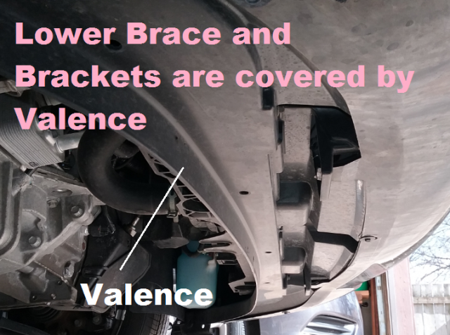

What may appear as one piece, is actually a set of "pairs" and a Valence - The "skirt" uses that front Lower Radiator support as the brace, the brackets bolt to it, the side braces give the skirt is "oval shape" and mount to the supports which have the "tabs" the Valence comes along behind and retains the rest of the oval round shape

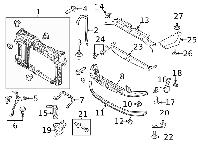

Thank! Looks like lower deflector D2BZ-8349-B #8 below and the valance which is actually 3 parts..the middle and the 2 end pieces. So #8,#11,#20 and what ever the one is for the bottom right.

Took the #11 off because when leaving parking lots with deep curbs, the sound of the nosedive scrape of that splashguard along with #8 bumping up the skirt so you see the hood shake, those actions start to get annoying real quick.
Unless you do some type of lift kit - the clearance of that lower skirt and bumper is pretty tight - the damage from those curb nosedives can do similar damage.

Yea I know what you mean about those. I always called them curb scrapers. I probably wont install those just the #8 in the diagram. Waiting now for my shop manuals and the wiring manuals to come in since I really don't trust my 2011 one to use on a 2014.
