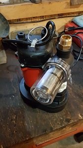

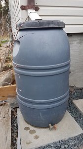

You will need a good supply of water. This is the medium by which most soaps work, therefore as a rule, the dirtier your car , the more water you will use. Most people will probably be on city water which is great for supply and cleanliness but then might have issues with hard water. Hard water will usually require the car being dried manually to avoid water spots. For those on a well (as I am) the idea of endless supply is a dream. I have devised a system by which I collect rain water in either rain barrels or a 1000L/265 gal tote. I can fully wash a car with about 1/2 of a 45 gallon rain barrel of water. I use a 1/2 HP sump pump, a selection of nylon fittings found at the local hardware store to adapt to a garden hose. I also have added an line filter with 100 micron mesh insert. Proper washing can be done, almost anywhere.

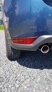

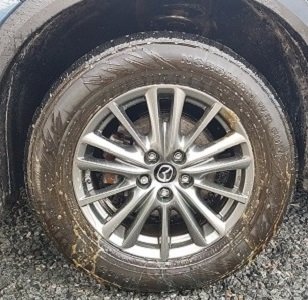

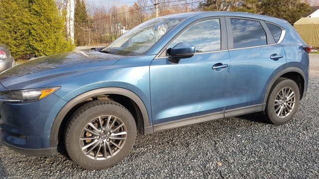

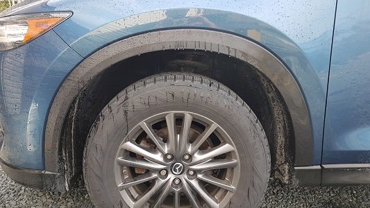

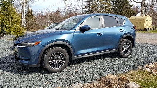

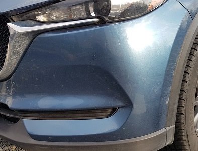

The Size-up - Here is the patient. My wife's '18 CX-5. It has not had a hand wash since last fall. It has had a few trips to the coin-op for a rinse only when really coated in winter salt. I do not use the pre-wash acid cleaners or the soap as the car is already coated in Colinite 476S right before winter.
20210501_190049.jpg 20210501_192800.jpg 20210501_192808.jpg 20210501_192830.jpg

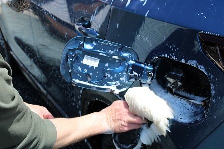

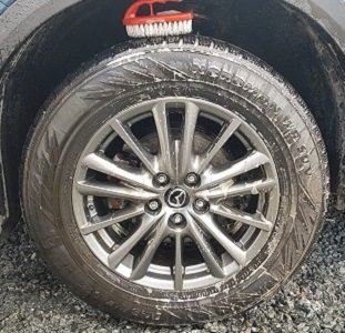

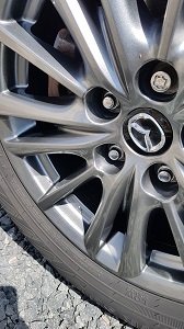

Wheels, Tires and Wheel well liners - I begin the wash process with cleaning the wheels, tires and wheel well liners. I will start by pulling out my white bucket I use for cleaning the wheels and filling it with soap and water (as warm as I can handle). I use a generous amount of soap to create a large amount of suds. My cleaning products of choice here are Meguire's Gold Class Car Wash, NAPA BodyPro Mag&Rim cleaner and NAPA BodyPro Tire&Bug cleaner. I use my dedicated wheel wash mitt, utility brush and rim brush.
>Using your water supply, lightly spray down the area around your wheel. This will dilute any chemicals that get on the paint while you are spraying the wheels. Wheel cleaners are a heavy acid or base solution and Tire protectants have silicone, both of which you don't want on your paint. Try to keep your tires and wheels dry so as to not dilute their cleaners effectiveness.

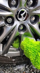

>With my wheel wash mitt and brushes in my soapy bucket I start at the drivers front wheel. I spray a liberal amount of tire cleaner around the tire. Then spray a liberal amount of rim cleaner between each of the spokes and on the surface of the rim allowing it to soak for a couple minutes. Using the utility brush, vigorously scrub the tire sidewall starting at 12 o'clock and working down each side. Scrub as close to the ground as possible. Return to bucket for more soapy solution as required. This will remove the dirt and oxidized outer layer of rubber leaving a clean surface for protectant (for more info, google "Tire browning & Blooming). If you have use tire products before, this will strip away those products along with any dirt or brake dust imbedded in the silicone.

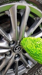

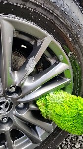

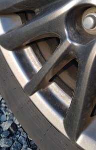

>Next grab the wheel brush and scrub all the way around the rim. Be diligent and scrub every surface starting outside and working in. Use a long brush to clean the inner barrel of the rim. Lastly use your wheel wash mitt to wash over each spoke, reaching around behind each one and between to clean brake dust from behind. Wipe the face clean around each lug nut. Finally rub the tire down with your mitt soaked in wash solution.
20210502_112119.jpg 20210502_112217.jpg 20210502_112221.jpg 20210502_112234.jpg
>Spray around the wheel opening of your next wheel to be cleaned and apply the tire cleaner and rim cleaner as above. Return to the current wheel and rinse the wheel thoroughly, be sure to spray in between the spokes and flush the lug holes. By the time you have rinsed the 1st wheel, the next wheel will be ready to scrub. Move your bucket to the next wheel to be scrubbed. Repeat the process for the remaining wheels.

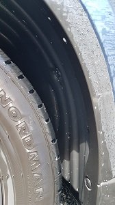

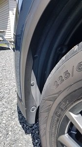

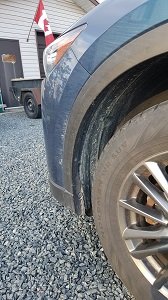

>After all the wheels have been cleaned, Go around to each wheel and clean the plastic inner liner using the wheel wash mitt. Follow with a full rinse, flushing out the wheel wells. Be sure to rinse up around the fender lip as dirt usually can be trapped up there. Flush the little shelf where the rear wheel well meets the rocker panel (and check for rocks, lol). Drain your wheel wash bucket, place items in bottom and submerge them in clean water. Set aside.
>If your wheels aren't clean or tires are still brown, repeat the process. This will subside once you clean your car regularly. A quality tire dressing will reduce the effort required to maintain a clean look as well.
>Alternately, if the wheels are heavily neglected and the front have a thick layer of brake dust, it might be a good idea to start with the rear set as the usually have less buildup.
>You can wax your wheels to help cleaning them easier, with a regular wax or specialized wheel wax.

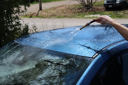

>Here is where we start the process of cleaning the paint. This will be the largest section although I break the car into zones, we will use the bulk of the water in our 2 bucket method. Here we need to be diligent and pay attention to things that could damage the surface. Heavy dirt, natural hazards such as seed pods or leaves, large insect skeletal remains etc.
Thoroughly flush with a heavy stream over the whole car from bottom to top and top to bottom, concentrating on the heavy soiled areas. Be sure to flush in any crevasses where fine dust could collect. The more you can remove or loosen now, the lighter the work will be and the risk damage to the paint reduced.

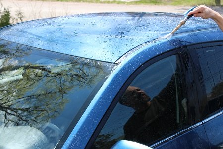

>Soak your wash mitt with clean wash solution and place on the roof of your car. Gently wash one side of the roof on your car. Pay special attention to the roof for sap, it will appear as little tiny dome shaped blobs. If they are recent, you can sometimes remove them with copious amounts of wash solution and lightly passing the wash mitt over the area repeatedly slowly reducing the size of the blob. Resist the desire to use your finger nail to chip it off. Regularly return to your 2 buckets to rejuvenate your wash mitt with fresh solution. Wash the windshield, mirror, side and back windows and/or trunk lid in the same fashion. Use the bug sponge on the windshield to remove stubborn insect remains, also run the sponge down the wiping edge of your wipers. If you are unable to remove bug remains from A-pillars, mirrors and leading roof edge with wash solution, consider applying a bug remover product as per instructions followed by rewashing the area.
Thoroughly rinse the areas well working top to bottom pushing the soap away in a sheeting motion. Flush well in crevasses, around trim and areas where soap can collect. Repeat for the other side of the car, be sure to overlap your work areas to ensure full cleaning coverage.
>If you are unable to remove sap from your car, I would suggest a clay bar treatment especially for moderately neglected surfaces. Heavy neglect can only be remedied with buffing using a compound. All these will require a proper wax or sealer application after.
The roof has a recess where the side is welded to the roof, usually covered with a trim piece. This area will collect debris like dirt, seed pods, leaf bits etc. as well as soap. Flushing along the whole trench from one end to the other will help to clear it, reducing build up and clearing soap residue.

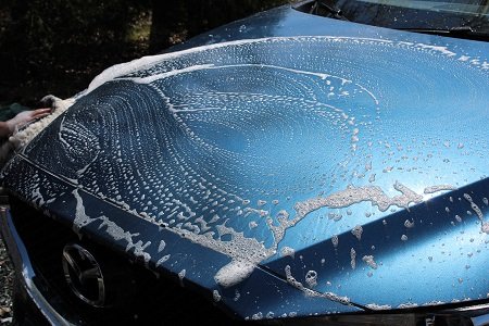

Hood and Fenders - Collect some fresh wash solution from your "Clean water" bucket and apply it to the hood. You can reach all across the whole hood spreading the suds. Be generous along the leading edge where your car will collect bug strikes. Resist the urge to scrub but instead let the wash solution do it's job releasing and lifting the bug guts. Be sure to get into the wiper cowl area where fine dirt can collect and clean the wiper arms. Return to your two buckets for fresh solution and clean each fender working from bumper to door edge and down to the rocker last. If required, with fresh solution, return a do a second pass over the leading edge of the hood.
Now thoroughly rinse the hood and fenders sheeting suds away. Be sure to flush the wipers and wiper cowl area pushing water to the drain points.
>If you are unable to remove insect stains from your car, I would suggest a clay bar treatment. If the stains are permanent, usually due to time, this can only be remedied with buffing using a compound. Both of these will require a proper wax or sealer application after.
>Even if you applied a wax or sealer, every time you wash, misting areas highly susceptible to bug hits with a quick spray wax can top up your existing wax making bug removal easier. Many quick spry waxes can be misted on a wet car and buffed off with a MF towel. For those who track your cars, apply quick spray wax to areas where rubber build up can occur to easy washing after track day.

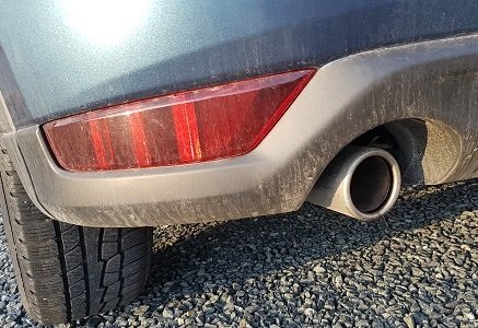

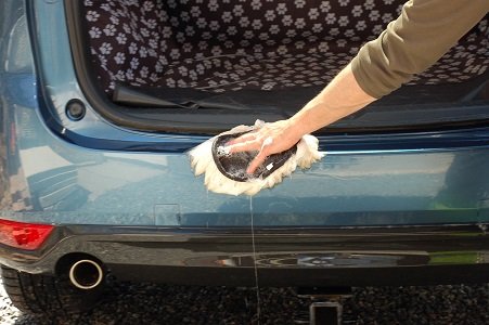

Rear Panel/Tailgate, Rear bumper - Once you have moved around to the rear of the car, apply liberal amounts of wash solution. This area is heavy in fine abrasives that can leave your paint with many micro scratches giving a spider web look or haze in sunlight. These particles get kicked up un the low air pressure area behind your car as you drive. Fine particles will settle in seams, around trim and behind your license plate. More solution will help wash fine materiel out of these areas and away. Work wash solution up under where the trunk latch and tag lights are located, open your trunk/hatch and clean dirt from along the bumper ledge.
Rinse the back area well top to bottom, flushing behind you license plate and up where the tag lights are. Be sure to flush in the seams around the trunk lid or hatch to clean suds and debris that collect there.

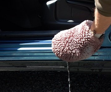

Rocker panels, Rear lower valance, Door jambs - I will now grab my #2 wash mitt. This will usually be last years body wash mitt.
Using the balance of the wash solution I will wash the rocker panels, scrubbing under behind the front wheels all the way to the pinch seam. Clean behind the rear wheels all the way around the rear lower valance. Wash chrome exhaust tip on the outside only, and around the recessed area the protrude the bumper. Open each door and clean along the threshold of the door and the bottom of the door.

And Now the Reveal, some before and aft pix...
20210501_192800.jpg 20210502_145443.jpg 20210501_192808.jpg 20210502_145535.jpg 20210501_192830.jpg 20210502_145454.jpg

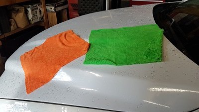

A little bit about drying after a through wash. Drying will reduce the formation of water spots & trails.
Dry the car using clean MF towels. Soak the towels in water and wring out excess. I prefer to use 2 towels at a time, and will swap out for fresh ones as I work to complete the drying process.
To start drying the whole exterior of the car, I drag the #1 MF towel (green) open to pull most of the water off the horizontal surfaces. Should any fine particles or dust be present this will flush them along with the water. By dragging, I am not exerting pressure on the towel reducing the possibility of marring the paint. I then follow up with a folded #2 MF towel (orange) to complete the process. Finally, using a lower grade MF towel wipe down the door jambs, under hood & trunk/hatch areas and seams. Clean compressed air or a blower is indispensable at removing water from around trim, lights, bezels, grills etc.
