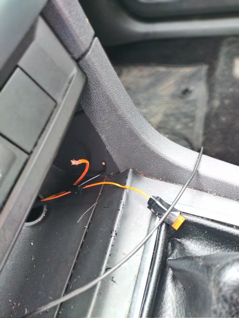

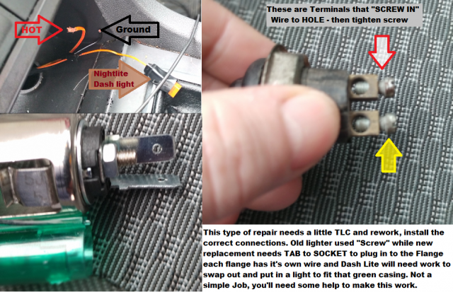

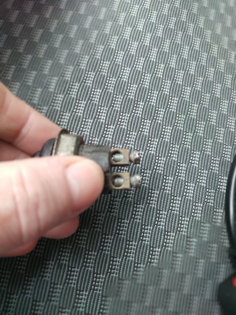

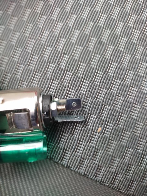

i am changing my cigarette lighter in my 2007 ford fiesta sport but when i took out the thing that was in there it was like a push button that tried to start the engine but its not the right part. so i took it out and i have noticed that there is only 1 orange push in plug thing and the new lighter i have is 2 1+ and 1- is do i need to get an adapter to make it a 2 plug or should i go to the garage and let the look at it as it seems easy enough to do but family members have said i done something wrong or ive got the wrong lighter
