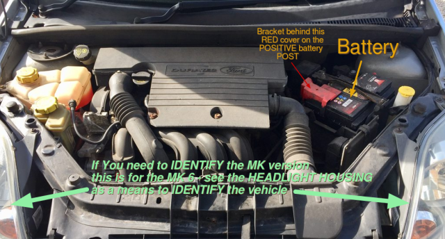

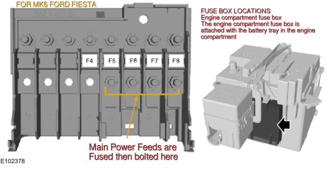

In the MK6 - the Fiesta had a MAIN Breakout box - or Engine Compartment Junction Box - which took the Battery power and broke it down into the wire feeds to various systems using a bracket/Fuse Mounting location at the battery.
Like this...
Engine junction box
Code:
FUSE                            Ampere rating            Circuits protected
                                  (Amps)
   F1                               N/A                           N/A
   F2                               N/A                           N/A
   F3                               N/A                           N/A
   F4                      40 Petrol / 50 Diesel           AC and Cooling Fan
   F5                               60A                    Lighting and GEM
   F6                               60A                    Ignition Relay
   F7                               60A                    Engine and Lights
   F8                               60A                    Anti-Lock Braking (ABS)

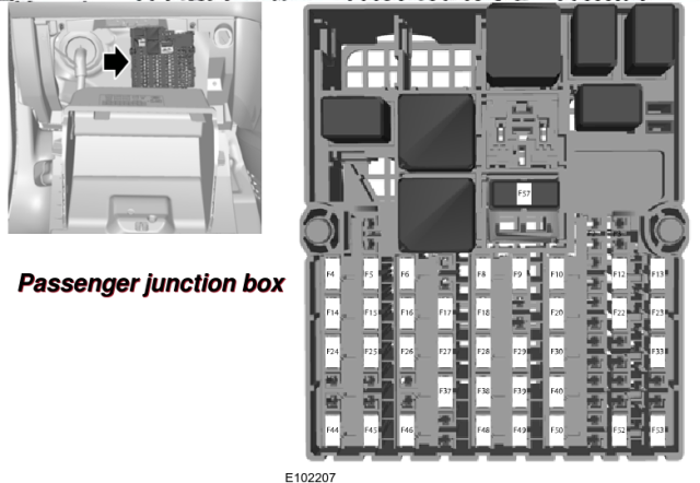

Then you have to look into finding the Glove Box, and remove it's contents and pull the Door down past it's pinch point stops (they pinch inwards - you'll find them on the sides of the box itself) and expose the Passenger Compartment Fuse Box...
(Might) - Look like this...
This is where the main power to all the smaller feeders goes, with the main power breaking out and fused in the Engine bay...
This then goes into the realm of your Owners manual for they changed Fuse ID's even by the YEARS it (this model version) was made so your Manual is the CURRENT version of the fuses and their location and ID you have...per the year it was made.
Example (MK6 only) (From the Owners manual listing the Passenger Compartment Fuses)
