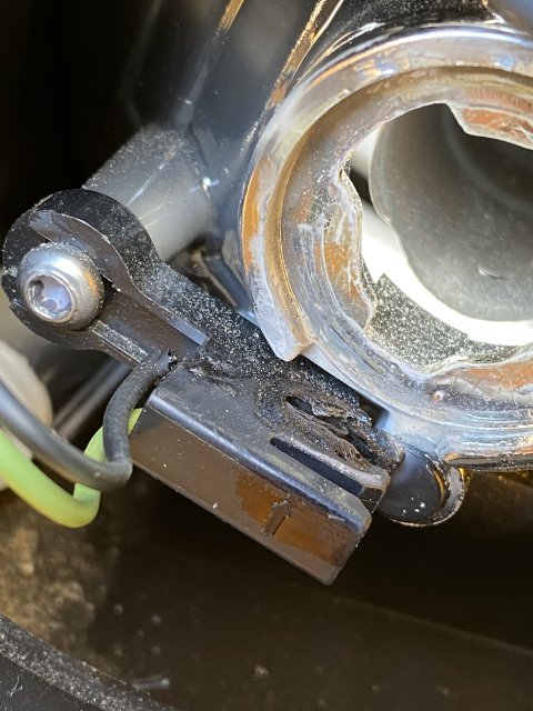

IMG_2758.jpeg I’m looking for this connector for headlight. Does anyone knows where I can find it?

The outer light - not the center hi-beam - uses a typical 3 prong pin you'd find on most 9004/9003/9005 - about 1/4" spade lug - so you can make your own if you need to.
