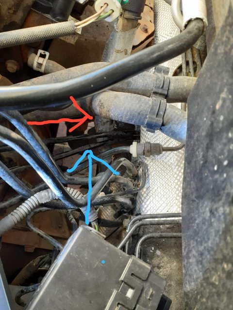

Good day fine people.
Recently acquired a 2006 1.6 2 door fiesta. RHD.
Awesome vehicle, but having some gear problems.
5th gear selects, bit does not actually engage, 4 difficult to get. Selecting gears does not seem "normal"
Seems like a linkage problem. Checked linkages and bushes inside at gear selector and at box. All in good condition, however feels like cables are catching somewhere.
Could someone please see attached pic, and indicate whether blue arrow cables should be behind red arrowed pipe. I believe this is where my problem is. Many thanks in advance

You could also have a worn out bushing at the point where the shifter cables attach to the transaxle. There shouldn’t be any play or looseness in that connection. You should also check the condition of the lower mount of the transaxle. If it has become damaged or more likely dry rotted from the heat and age then it will also cause a difficulty to engage certain gears.
