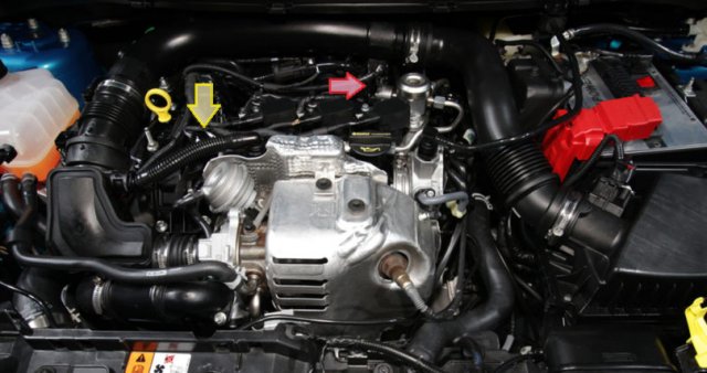

I only know of two locations...
Here and Here
Since I'm using a Focus and Fiesta - this is a concern. For Ford uses a similar Fuel delivery device in both. (Eco - not all NA 4 cyl) although on the Focus - if they are GDi using a similar fuel system even for NA. (That silver thingy that my local dealership cannot give the true name for)
So do I have the locations correct? Else you'll have to teach the rest of us of what you're up against.
