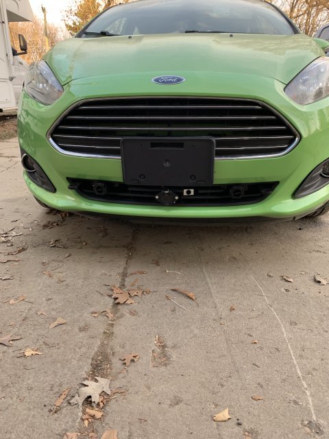

Welcome to the forum. You and Ellwood P. Dowd are the resident experts here! Most of us here don't (yet) have the required RV. The lightweight Fiesta is a perfect car for this. I had thought that the Smart for two would become a very popular "toad" choice for the RV community, but I have never seen one behind an RV. The Fiesta is a very comfortable pick.
Please discuss your hitch choice and what transmission option on the Fiesta. Also be interested in learning what you have to do to have brake lights function while towing and such.

Hi. I am actually considering using my 2018 Fiesta sedan for flat towing. I noticed your Fiesta has the lower mounted tow bar attachments in the lower grill (probably 14-3/8 inches above the pavement). Mine would have to go in the upper grill (22 inches above the pavement) because of the height of the hitch on the RV. The tow bar would then be about level without using a drop receiver that would scrape my driveway when pulling into the street. My Fiesta is an automatic. I understand the battery on mine would have to be disconnected while towing.......The center brake light seems to be the only item the installer wants to avoid dealing with.
