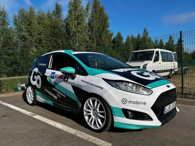

Hello,
I have a Ford Fiesta 1.0, 92 kW, 2015.
Programmed Pumaspeed 2 stage. Air intake, exhaust, downpipe.
After power measurement - 105 kW. Turbine pressure ~1.45-1.55
I found that the accelerator pedal reading is ~60.7% when fully depressed. I replaced the pedal, the throttle, the vacuum pump, checked the turbine, also replaced the engine control unit. Spark plugs and ignition coils also replaced.
I have no idea where to look for power
Perhaps you have experienced this problem and can help?
