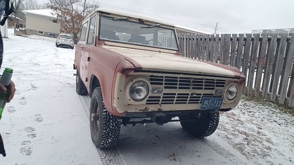

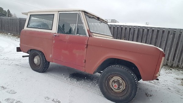

Its a '69 Ford Bronco with a factory 289ci V8 and 3 "on-the-tree"
The car belongs to a friend who I met years ago working for a stamping & welding supplier to Honda Canada.
We were both Ford geeks at the time. Me Mustangs & a Lincoln MkVII, and he was a mustang nut plus his dad "Wayne" was a Ford Tech.
It belonged to his father and was licenced up to 1980, then spent a good part of the 80 in pieces. Reassembled and spent the 90s and 2000s as a plow truck after Wayne retired and continued to repair cars in his garage/shop. Wayne passed suddenly about 5 years ago.
Its actually a 1970 tub and doors pulled from a local wreaker that was in a front left corner collision. There is pretty much a complete bronco of parts in the shop collected over the years too, short of a frame and top.

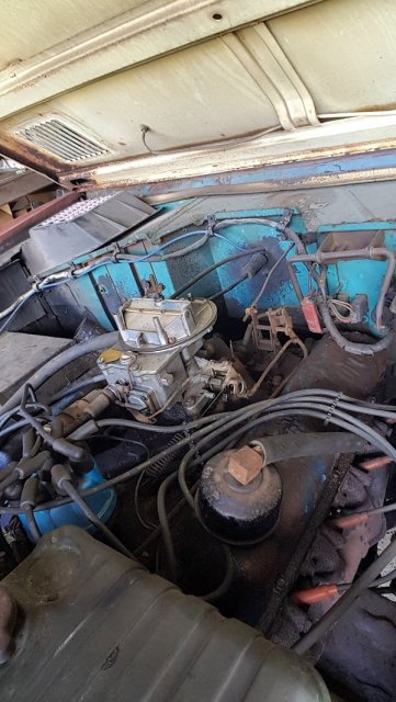

Back in the summer I rebuilt the carb for my friend, he said it hasnt run that nice since his dad was master tinkerer on it. I thoroughly enjoy working on it. Its quirkiness and simplicity is only appreciated through experience. Unfortunately they were not built to make 50 years and this one has made it this far through luck and love.

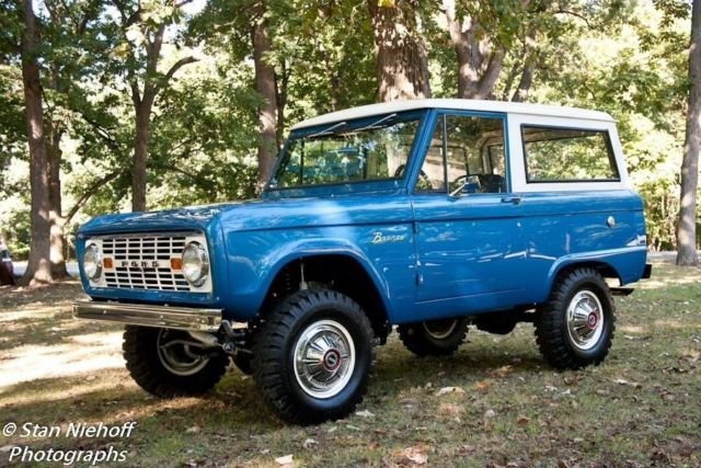

My friend is not in a place to be able to take on a resto project right now, but rest assured it wont get neglected. This is what I envision it could be...

Finding parts for a low production vehicle has been the hardest part. But the simplicity is priceless. My friend couldnt believe I could set the carb float with the engine running and the top horn removed from the carb.;)
We had a heck of a time finding a fuel pump for it back in the summer. He had purchased a 80s 5L Mustang pump because we needed something. Then we found a non-OEM NOS replacement in Kentucky and had it shipped up...possibly the last one in existence! You see, the fuel pump is specific to the Bronco because it also includes a vacuum pump to operate the vacuum wiper motors. We also talked about fabricating an electrically operated vacuum pump to mount on the fender and running the more common Mustang fuel pump. However my friend wants to keep it as much a period time piece and wants to do very little to change it. In 1970, Ford went with electric wiper motors but also did away with the fold down windshield and removable door window frames. We figure it had something to do with this safety nut back then, you my have heard of...Ralph Nader!!?! :ROFLMAO: He also wants to keep all those dangerous features.
We are now in the hunt for an air cleaner that uses a paper media filter. The original unit is an oil bath system, which will be kept for historic value and can be reinstalled as required. Im accustomed to oil bath from old farm tractors but agree they are messy and cumbersome for day to day.
