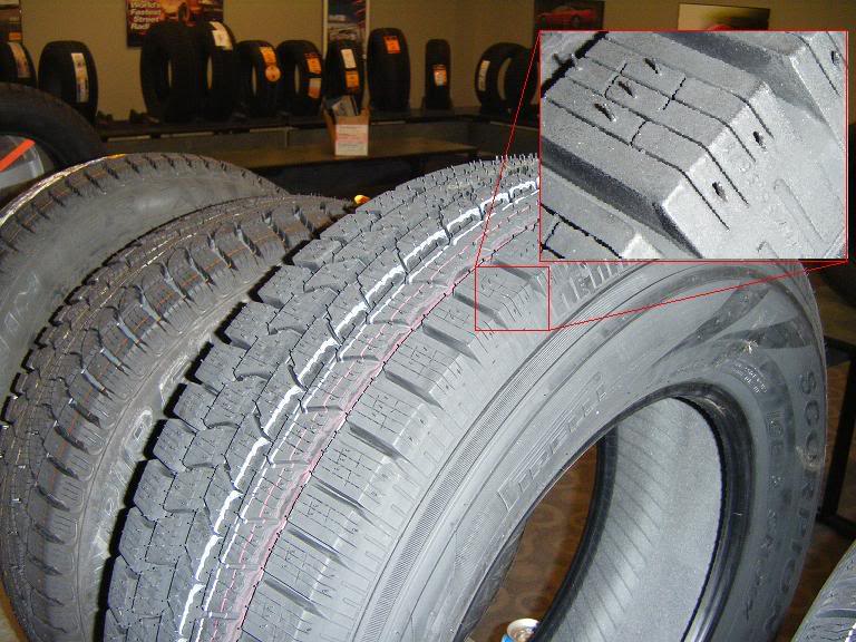

This picture shows a winter tire tread design which, as you can clearly see, utilizes a large number of sipes:
When the road gets snow covered the tire is no longer able to conform to the surface.
The siping allows the tread elements to flex under stress create aggressive "biting edges" when braking, cornering or accelerating.

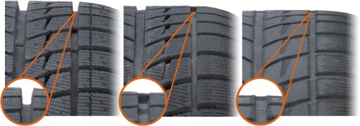

Part two of our three piece traction puzzle is tread depth.
While deep snow and ice-covered roads are two of the most challenging conditions North American drivers will face, tire developments during the last decade have noticeably advanced wintertime mobility. The technological revolution of dedicated winter tires for drivers in the snowbelt, and the continuing evolution of all-season tires for drivers living on its periphery characteristically offer more grip in snow and on ice than ever before.
However the basics of delivering traction and handling in snow and on ice remain unchanged. Tires must combine three fundamental features to deliver good wintertime performance, including an appropriate tread design, pliable tread compound and sufficient tread depth. If any one of these fundamental features is absent then the other two, regardless of their ability, cannot deliver the desired results. Since engineers can develop cutting-edge tread designs and chemists can develop advanced rubber compounds, it is often the remaining tread depth that is the variable in determining wintertime performance.
In most parts of the world, tires are considered to be legally worn out when they reach "2/32" (approximately 1.6mm) of remaining tread depth. U.S. law requires tires to have easy-to-see Tread Wear Indicator bars running from one side of their tread design to the other when the tire's tread has worn down to the minimum legal limit of 2/32 inch.
However in spite of the legal minimums, it's recommended that drivers expecting to experience wet conditions consider replacing their tires when they reach 4/32" of remaining tread depth. Tire Rack tests have shown how shallow treads reduce wet braking traction and increase stopping distances.
We also recommends that drivers expecting to encounter snow-covered roads consider replacing their tires when they reach approximately 6/32" of remaining tread depth to maintain good mobility. Tires need more tread depth in wintry conditions to compress snow in their grooves and release it as they roll. If there isn't sufficient tread depth, the "bites" of snow that can be processed on each tire revolution will be reduced to "nibbles," and the vehicle's traction and mobility in snow will be reduced.
