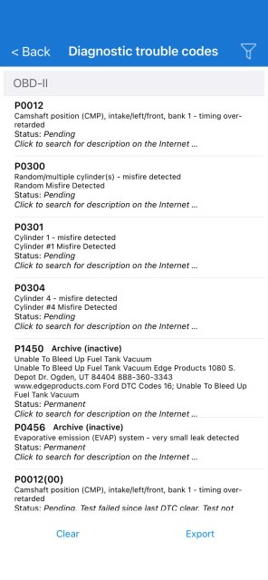

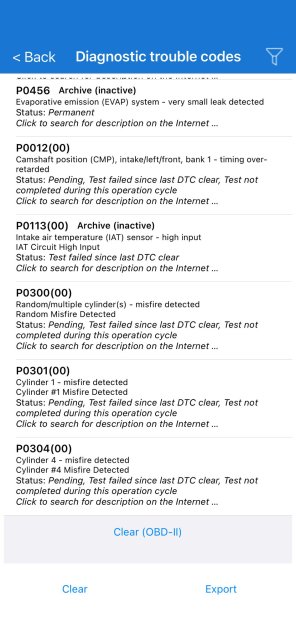

However, a new issue appeared: when engine speed exceeds ~5000 RPM, the check engine light comes on. During acceleration, the engine vibrates and produces a deep, rough sound. Because of this, I suspect a possible issue related to the camshaft phasers / VVT system.

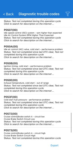

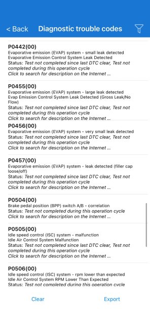

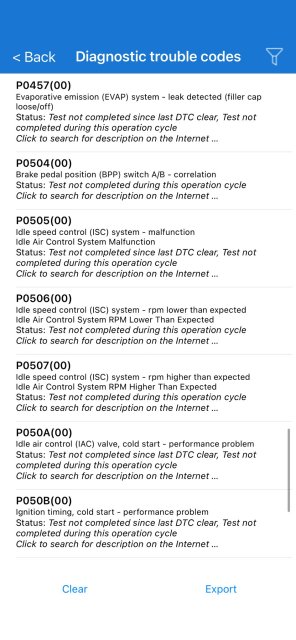

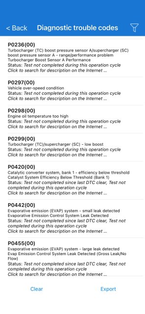

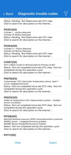

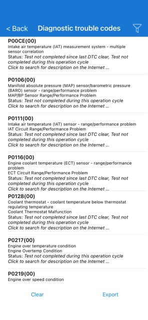

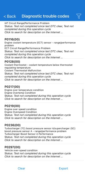

On diagnostic scan, multiple fault codes appear, many of which seem unrelated to each other, and I doubt they represent real, independent failures.

Do you have an inspection camera?
Pull the plugs, inspect them too. Look for changes in thread or gap - look for hammering - it means you may have the issue of too advanced VVT or the valve train itself is not timed correctly (in advance or TDC) so the plugs may get hit too - meaning oil pressure issues and the piston to head distance is too close due to the timing is not right.
Misfires signal a combustion chamber not at the right mixture or not enough to combust - poor vacuum.
Can also set an over-speed condition where the cams centrifugally are advancing more than the oil pressure would allow per sensor readings at the camshaft position sensors.
Also check the grounds - errant spark noise can cause errors in reading due to the noise induced by poor spark plug gapping.
