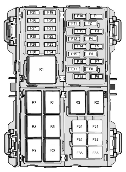

You have several modules, but they all retrieve power from the Battery and that starts back at the Battery, it's RED terminal, then onto the Fuse Box in the Engine compartment.
It sounds like you may have blown a fuse or popped off a connector you shouldn't have when you were working around it.
So your modules get power from the main engine compartments' fuse block so I'd start there - grab the owners manual and start your investigation.

It's far easier to look for a blown fuse first - you may even find some fuses are corroded or have lost contact and just need to be pulled - wipe off the tab contacts and then reinserted to re-establish contact so the circuit is complete.

The Body control Module - located by the Glove box - and so is the Fuse panel for the passenger compartment.
You'll need to open the Glove box, empty it's contents and then pry down and pull outward to release the cabinet from the panel to see that Fuse Box that may have your answer.
