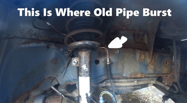

I changed the pads on the front drivers side, caliper was seized so I had to push it open to fit the pads in , then connected it all up and went for a small spin, I thought it would be a good idea to press on the brakes extremely hard to check the braking power when I did this I immediately heard a sound from the wheel well as well as the brake pedal sinking to floor on top of that there was steaming brake fluid shooting out from the wheel well, I then left the car for 24 hours and came back to do an inspection I first thought it was the caliper without fully inspecting it but once i looked I saw that the copper brake pipe was soo rusted/corroded due to the salt in the road in Scotland I guess and I saw exactly where the fluid was coming out from, it was on a bend where the Pipe burst open, the hole was no larger than maybe a mm or2,
So I removed the burst Copper Brake pipe, the brake flexi hose and the caliper.
Because I waited 24 hours to check on it All Of the Fluid has now drained out from that rusted copper pipe, from the master cylinder reservoir and the master cylinder is now empty and full of air I presume?

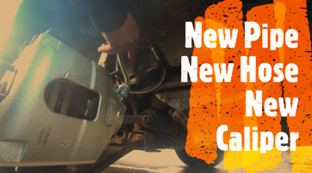

A friend of mine which is a Diesel bus mechanic came by after I fit everything back together and told me that I dont need to bleed the master cylinder and I would only need to bleed the one caliper where the pipe burst as he said that there will still be brake fluid in the other 3 caliper pipes, so we only blead the new caliper and I threw the wheel back on and drove it around for a little bit and she was fine!,
I still think I should bleed the other brakes to make sure there isnt any air in them.
Ive posted a couple of photos showing the New Stuff I installed Plus a new Disc and pads
Thanks again for your help
1,455
1,140
Good to see you get this mess taken care of and back on the road!
Nothing like having to do this yourself.
And when it comes to the other three, yes - it's a good idea - WHEN you have more time to pay attention to details.
Just don't make it too long.
