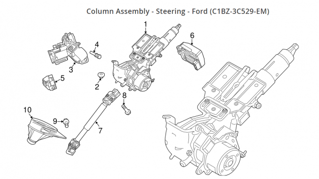

Figure 7 is the rod that turns the pinion gear of that rack - but it requires the boost from Figure 1 which contains the toothed gear sensor and the motor to bump the steering (reduction gear and logic units are not going to get discussed but the Figure 6 is the buss for the Electrical power to this thing.)
One thing I wanted to point out, is the extension rod has a sleeve that makes it slide up and down that gear-like shaft (tongue and groove teeth mesh together and allow Figure 7 to change its LENGTH without Freeplay)
What I wanted to bring to your attention is the use of FIG 1s' folded curl piece that installs this onto a crossmember - just under the pods - it uses two bolts and slides - if these bolts are too loose the steering wheel can shudder and seem loose. But if it's too tight then you may have problems trying to adjust the column to suit the users' needs and ride comfort.
One main problem I was having was with the steering wheel bounce - or a rattle - which was caused by those loose bolts.
I removed the trim that tucks under the pods console (dashboard) and it will reveal where that fork slide "rides" on the crossmember and the bolts hold this wheel assembly to the crossmember.
Part of my problem with steering and alignment was due to this assembly - "vibrating" and when you hit bumps - you get a pull or tug on the steering wheel from that freeplay or shake - in some instances that shake is enough to make the vehicle steer in a specific direction.
To find out what I'm talking about - remove that trim piece - the cover to the steering console just behind the steering wheel in the column. You'll see those two bolts.
Release the lever that helps you adjust the tilt and distance (throw) you see the console may drop - but take the bottom half of your steering column where you put in your ignition key and see if it can rotate or twist - if it does - those bolts are too loose you might want to tighten them up.
