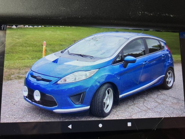

I have to say that the fog lamps are not the same between the UK and North America built Fiesta’s. Different continents and rules along with a few years separating them being the reasons.
I find it interesting that these factory optional lamps are still highly desirable after so many years. They are not really very good at lighting our paths and are a huge pain to “add on” after the car was built.
for almost the same amount of expense anyone could get a pair of Hella or KC lights installed and wired separately from the vehicle system that would rock their driving lamp loving world. IMG_0877.jpeg
