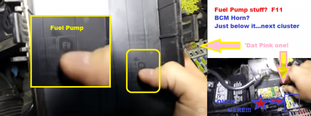

Someone mess with the Fuel Pump or it's relay?

I guess we'll start simple - have you checked to see if the Horn works then the BCM is getting power - if not - the Horn Fuse may have blown.
No Horn? If that fuse to the Horn Relay blew, much of the BCM (Body Control Module) quits working.
This would affect the Fuel Delivery system and also not set any codes. It'd crank all day - just no codes.
So IF horn works - then we have to look into Relays...and the Body Control Module.

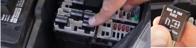

Pull out the Owners manual and VERIFY
the RELAY is not blown - will require a Ohmic check
and test the contacts to make sure it's not blown open internally.​
To be honest, it's easier to grab/buy a spare relay - maybe two - because the CONNECTOR TERMINALS have different widths - but only uses two type of widths.
A/C and Radiator Fan use one type of width, others use a different width - you'll see what I mean when you try to install a narrow toothed Connector type-relay into a socket that needs Wide-width Connector type-relay and vice a versa....
So if one Relay goes bad, you can try to swap with another of a similar rating and Connector Size, - but not all relays have the same size connector "tabs"
