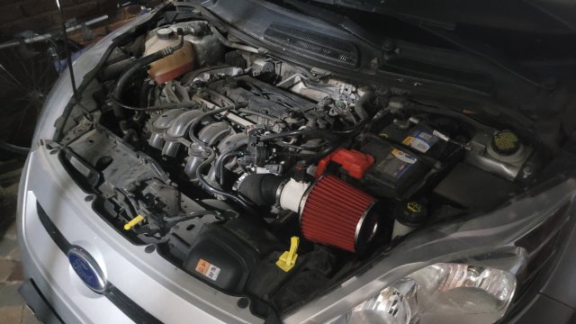

Hey guys!
Lately I wanted to put a cone air itake on my fiesta to have more intake sounds and found out that ford engineers put the MAF sensor on the air filter lid. Thus after many prototypes I've finaly finished a 3d printable air intake adapter for the ford sigma. I decided to give it out for free for the community. Its an stl which you 3d print in abs, pp, or pla and can pair with a 3 inch air intake, I'm gonna leave a picture and a video for yall to see. Enjoy!
If you print it with PLA please do take in consideration that there are extra steps in the link to anneal the plastic.
