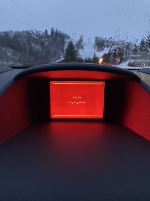

My daughter's Fiesta 2011 has an issue with the clock and the stereo.
First the clock:
It doesn't show either date or clock, and it's impossible to adjust. I get into the meny, but there is no reaction to the adjustments.
The clock shows up like this:
I have tried disconnecting the battery, touching the connectors, pulling the fuses, and even changed the display and the radio unit from another car. Still no change.
The display and the clock does not follow the radio unit, because it would normaly be possible to adjust the clock seperat from the radiounit. At least it appears so to me whn I connected the display without the radio unit connected... So where in the car is the clock actually then...?
The radio unit does not follow the ignition. It works like when it's no key in the ignition, like I turn it on and it stays on for an hour. I also have to turn if off manualy when I leave the car.
The power seem to be ok. Constant power is ok, and there is one wire that delivers power when I turn the key, and off again when I pull out the key. The rest I assume is wires to the display and the speakers.
The garage hesitates to work on it. I have searched the internet, but nothing like this issue.
There is also a load of codes when I read out. Not abel to delete them so they are constant. Some of them are dated in 2033, far in the future...
Most of them look like the Can-Bus needs a serious reset beyond disconnectiong battery...
What to do?
