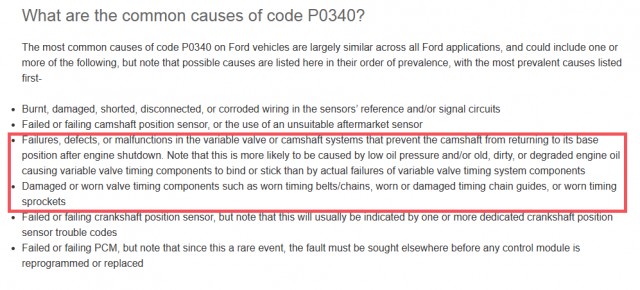

I'm going to provide a link...I'd like you to read this article...
https://www.troublecodes.net/fordcodes/p0340/
Pay particular attention to this statement...
Where am I going with this?
Fords have a Crankshaft position sensor too, and so does pretty much any vehicle with an engine in it these days.
