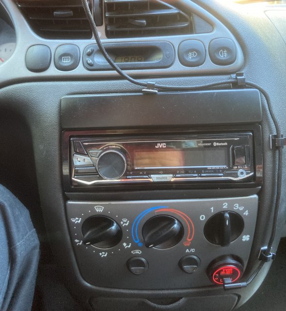

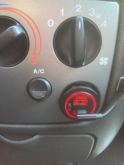

i just replaced the cigarette lighter with a usb port. Super nice but unlike the radio unit, this one doesnt turn off when turning off the car. It does have a on/off button but its annoying to have to do that every single time. Is there a way to adjust the wiring or whatever to have it turn off when turning off the car?

You would have to rewire the unit to a keyed source. Ford generally wires 12V power ports/cigarette lighters to constant battery 12V.
1,959
1,638
Power points need better wiring than the small gauge stuff that is only suitable for "intermittent" use, such as the cigar lighter socket was originally intended to do.
If you move the connection to a constant source you would need to remember that anything you plug into that circuit absolutely will draw your battery down to zero unless it has built in auto shutdown capability.

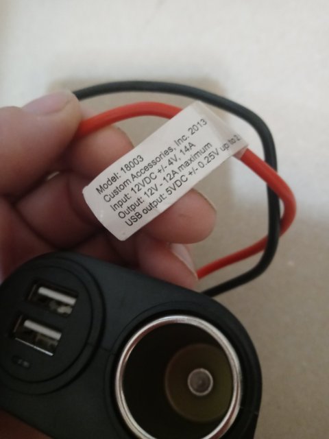

This is intended to be properly connected with a 12 volt power source and can draw up to three amps when all are in simultaneous use.
The maker of this component specifically states it is not to be used with a 12 volt electrical plug as it's connection to the electrical system! 17191257013896845392994731696320.jpg
