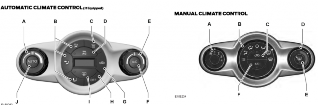

However, you own a Titanium - this may have a type of climate control system where the system "closes off" and moves the drum inside the climate control system once the system is not needed and you've shut off the ignition. It parks itself - you may be hearing the system park itself - this occurs after shutoff but not right at the shut off time - it takes several minutes to start and moves the vanes and drum for several moments - as it needs time to complete so you may be hearing the motors moving the drum and closing off the outside air port.
Depending on the system you have, Automatic - the one on the Left "Cycles" and can park itself to "Closed position" when you're parked and the ignition is off and it's not being used. The one on the Right is Manual and leaves itself where it's set at. But if you move the knob, with the ignition off it will cycle to "park itself" and the relocate to the new setting. But it may not be able to complete this until once the car is started again. Because; when the engine and ignition is off there is a timer on this length of time it can do this - so it will try to move to the new control setting - but it may not complete until the car is started again.
