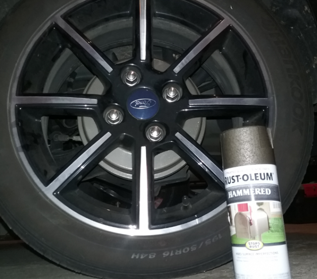

Nice car!
I have a 2018 - Ford Fiesta SE one in Black, but have "aluminum Spoke" wheels...
Have Disc on Front, but Drum on Rear...
The "original" Gloss Enamel black does not stay on well...so I tried verious methods and used some simple spray paints.
One word to help - don't make it a glossy finish, wont look right - I'll leave it at that...
IT works better to view if you use a matte or semi-gloss to take the shine off of it so it looks more natural.
Tried various textures to find the right trade off.
Gun Metal - although ok, may not look right to the "black" you have in the rim
So I tried different shades of metalflake and texture paints.
One time I painted those Drums Dip-RED (a nice matte finish) to tickle my wife's desire for "Hallmark Channel" and the "red pickup" - but didn't last long. Not too many people have a sense of humor like my wife has...
So switched to this...
...excuse the dirt - it does enjoy playing in it...
The matte wears well and since it's a common paint color - and texture - seems to mesh well with the tradeoff of color and shine.
Your mileage may vary...considerably...

Nice car!
Well thank you! I have turned it from stock and it had slowly turned into very modified look wise. Nothing mechanically.
I do like the look you have in the picture. Silver has crossed my mind but don't want the dummies' to stick out to much
