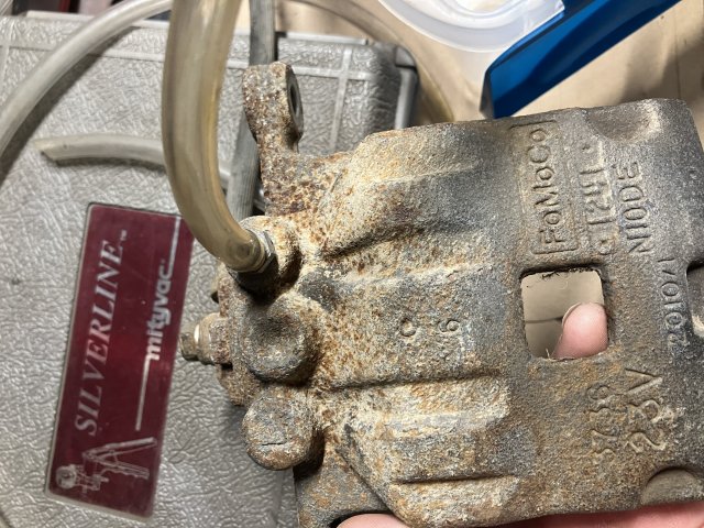

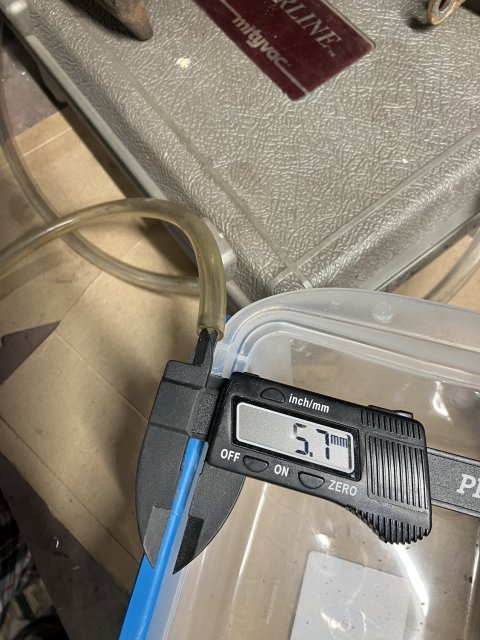

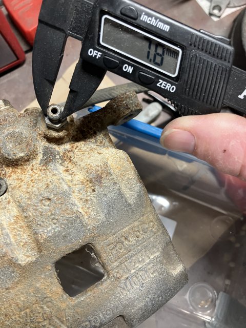

I use a Mityvac tool to bleed out the system and have purchased clear vinyl hose in various diameters to use for this. I like the clear vinyl because It allows me to see the fluid being purged.the hose material is extremely flexible and fits tightly over the bleeder. EC57BC7A-D083-4A61-BDB9-F84913DA441A.jpeg 6C7F7D79-FC8C-4AAB-B439-A59CCDF080C1.jpeg C166D2F4-79D2-486B-A101-E9B8F3152F70.jpeg

I use a Mityvac tool to bleed out the system and have purchased clear vinyl hose in various diameters to use for this. I like the clear vinyl because It allows me to see the fluid being purged.the hose material is extremely flexible and fits tightly over the bleeder. View attachment 7932 View attachment 7933 View attachment 7935
Oo super helpful thanks. Looks like 6mm is probably fine I’d say then.
