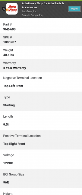

Ok, so you'll want to try and keep the same size and type of battery orientation.
So you'll need a 96R Group Type of Battery it's "Standard" 96R 9 9/16L x 6 13/16W x 6 7/8H or in mm 242 x 173 x 175
This size is unique to the Fiesta - so it you wanted more amperage in a rating or bigger plates - you might be pressed to find something. The 85 or 86 Group series is similar in BASE footprint dimensions - but taller - so it has room for more plate surface area. BUT NOT TERMINAL location - it would be on the wrong side.
Also - the "R" suffix, again, places this in a unique category, place the battery with it's terminals across left and right sides of it's face (Length) the "R" refers to the POSITIVE terminal side and is located on the RIGHT side of the Battery - again oriented with its' "Face" towards you.
Now as far as CCA? Cold Crank Amps? The Fiesta is not a hard starter - it's less than 2 quarts so about the size of a Coke 2L bottle is air is compressed / displaced during it's 4-stroke revolution (360 being one turn with 4 cylinders - but needs two turns to make 4 strokes of up and down - displacement) so you do not need a heavy Diesel Semi Truck battery to start it, but you DO need good connections to it - so the battery is important but the connections to it, are even more so.
Same applies to the Alternators connection to the TERMINAL BLOCK that bolts to the side of the top Positive terminal. So if you're going to have the battery replaced, clean and fix any and all of the connections to it at this time.
