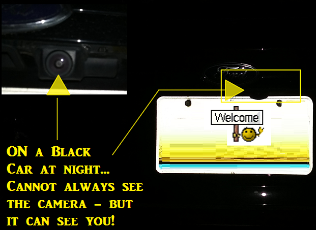

Did you check to see if you even have a camera?
As In: Still attached?
Reasoning is this:
I've had some close calls with other vehicles that have lift kits and high - mount KC Lites - they have been known to not pay attention - READ THIS AS: TEXTNIG while DRIVING - and if the inevitable were to occur - you'd lose the camera due to the rear -impact - doesn't have to be on the road, the trip to the Grocery Store can cause this too - people attempting to park behind you - hit you - then leave the scene - with broken stuff left behind in a pile at your back bumper.
