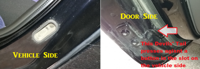

On my vehicle I several types of door ajar buttons, enclosures addendums - like below - on the rear doors - and only on the rear doors.
Does your car have this?
Check the alignment and throw of these - if they don't match up or have busted a seam in the gasket grommet - allowing water entry - this can cause the event you're having - the vehicle thinks it's being broken into. You can clear it, but it just comes back.
I've had lost a blanket due to the "stab wound" this setup can do - so if you have car seats, blankets or some type of cover for the seats, make sure it's not pinching in areas like shown above - it can affect the ability for the closure and door ajar sensor condition to clear properly.
